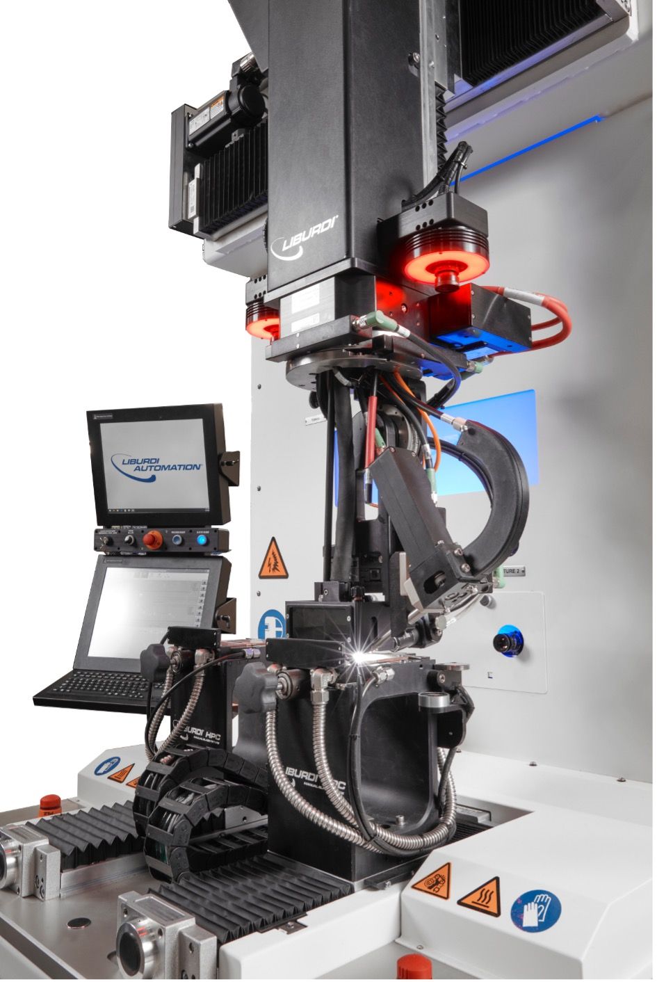

Many automated welders still require an operator to fine-tune the ongoing weld to cool down or heat the melt pool, increase or decrease travel speed, and move the weld head up or down to increase or decrease shield gas, depending on the substrate’s condition. These incremental changes rely on the operator’s experienced eye and history, which makes them subjective.
Subjectiveness can be gradually removed by using in-situ optical monitoring. Each completed weld increases the algorithm’s robustness, teaching the machine what to look for in the image, including arc gap, image brightness, melt pool geometry, feedstock position, temperature, etc. When implemented, these tools help accurately track the weld seam centerline and change weld parameters on-the-go to maintain a specific melt pool cooling rate target or account for a thickness change within the substrate.

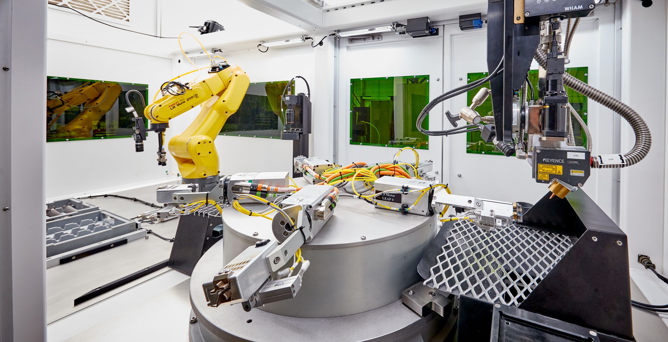

The best flagship machine that sums up these innovations is the LAWS1000 FA, which can be used for manufacturing or repair processes. The 1000 FA has automated the process of loading and unloading low-pressure turbine blades by using an optical character recognition process to automatically store blade information (serial number, stage, engine, etc.) and link it to welding parameters, quick disconnect custom fixtures, offline scanning and toolpath generation, coaxial or lance powder nozzles, extraction system, etc.
