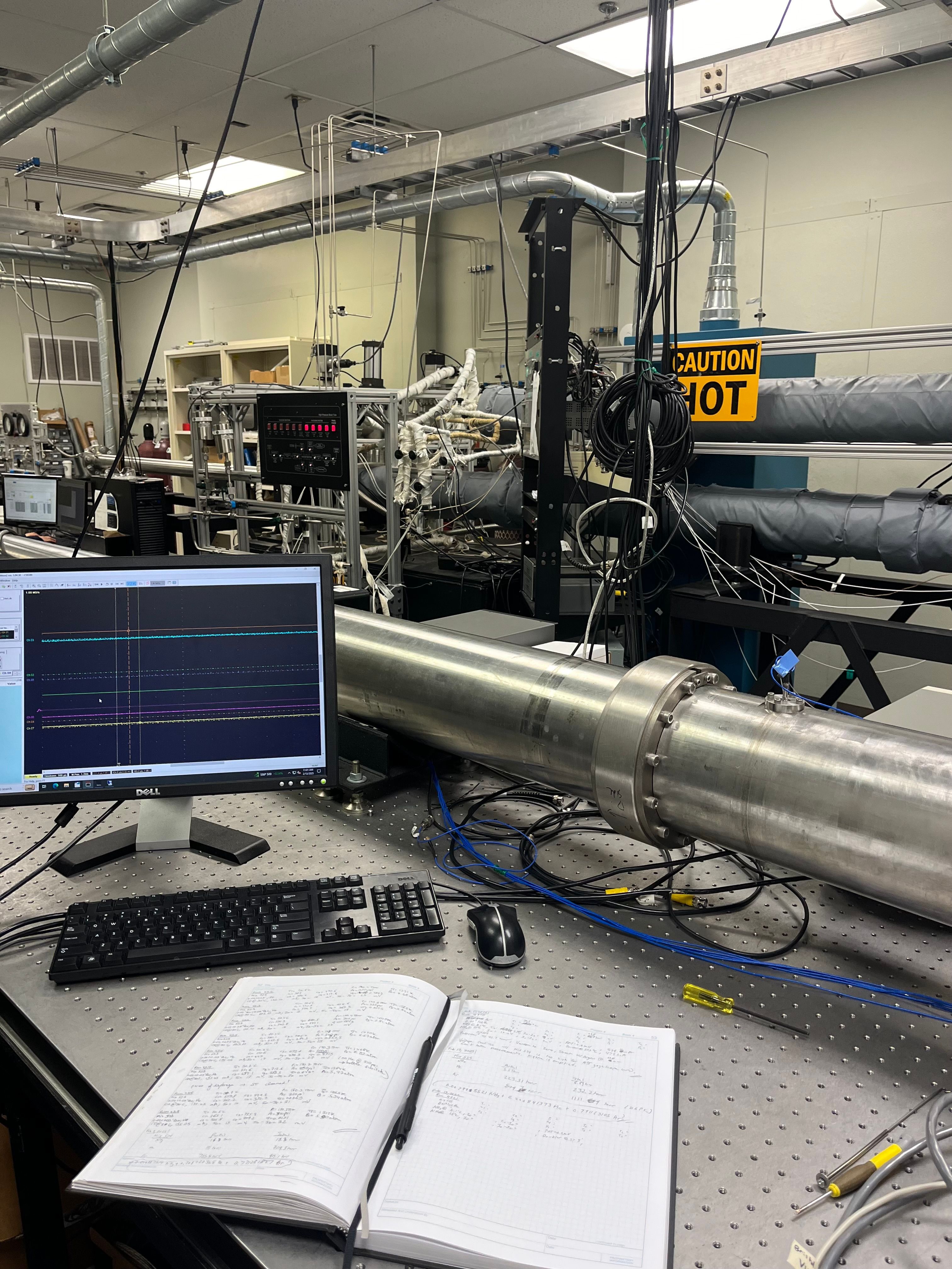

The last test cell was conducting combustion-related research with shock tubes, and Dr. Delgado handed off the tour to Dr. Claire Grégoire, a post-doctoral researcher at TAMU. “It’s a long piece of tubing split into two sections separated by a diaphragm,” Grégoire said. “We study the gas phase of a mixture that can be fuel-air or electrolytes in a lithium-ion battery. We fill one side with pressure so the diaphragm breaks and sends a shockwave, igniting the mixture on the other side. Optical or laser elements monitor the combustion properties.”
Two other students were assessing oil combustion properties with the same shock-tube technology, deploying the aforementioned laser absorption spectroscopy to measure the concentration of specific chemical species precisely. This allows researchers to study combustion kinetics at high temperatures and pressures by tracking the formation and decay of key reactions.
