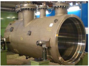

LP compressor[/caption]

The conventional beam type compressor arrangement consists of two compressor bodies and therefore 4 DGS. The integrally geared option requires a minimum of 8 compressor stages and therefore 8 DGS. Ergonomic design is an important Gorgon Project goal for the plant operators and maintenance personnel. This will improve the safety aspects for maintenance/operation and enhance the overall plant operability and reliability. The conventional beam type compressor can be designed to improve access to bearings, seals and rotating assemblies. The barrel type compressor arrangement selected does not require the process piping to be removed for normal maintenance activities. Integrally geared compressors require removal of suction piping, head covers and impellers to access DGS, and removal of discharge piping, stage casing and upper half of the gear box casing to access journal bearings.
From a safety standpoint, the HP barrel compressor has been designed with only one head-cover (3rd suction side) while the 4th stage head-cover is integral with casing and avoids the risk of high pressure leakage. The integrally geared option needs head-covers with relevant sealing gaskets on all 8 stages. The class of CO2 compressors used for this application are complex regardless of the type of compressor chosen. The barrel compressors are each located on opposite ends of a double ended VFD.

The Gorgon Project facility on Barrow Island is located off the coast of Northwest Australia in an area prone to tropical cyclones. As such, the facility is designed to withstand cyclonic wind loads and operate through major storm events. The barrel types compressor casings are more suitable to withstand the large nozzle loads that result.
The design basis for the compressors is to handle up to 20 times the NEMA flange loads. Integrally geared compressors with the scroll connected to the gear casing do not lend themselves to the same levels of flange loading. The overall efficiency is higher for the integrally geared options resulting in lower compression power.

The increased inter-stage pressure loss minimizes the overall efficiency improvements between the two options. In addition, at the time the compressor type selections were made, integrally geared compressors were not referenced for a combination of the flows and discharge pressures required for the Gorgon CO2 injection application. The final result of the review was to select the barrel type compressor primarily due to the ability to minimize the number of seals, improve the maintenance access and to accommodate the cyclonic wind conditions that would be experienced at site.
