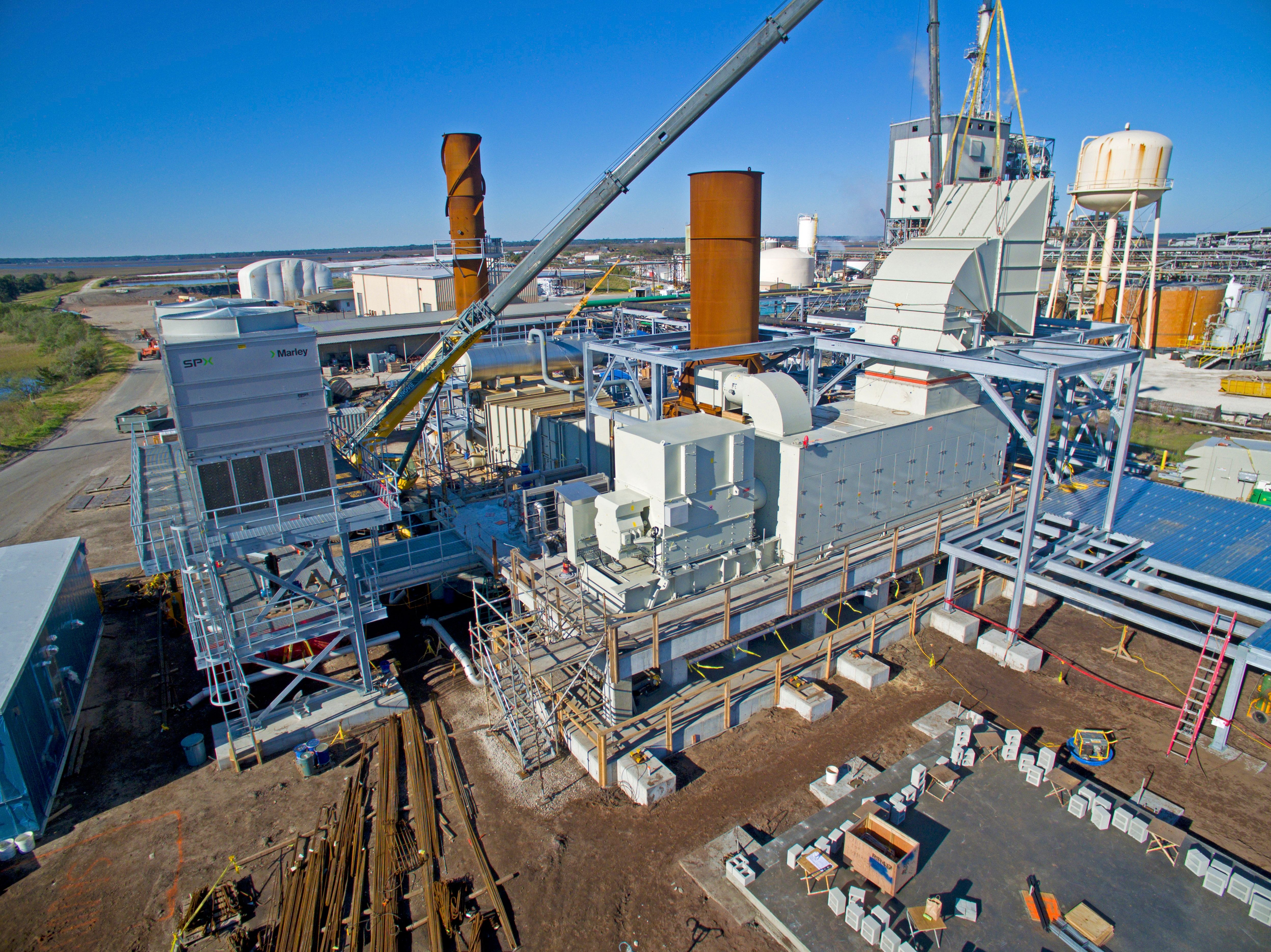

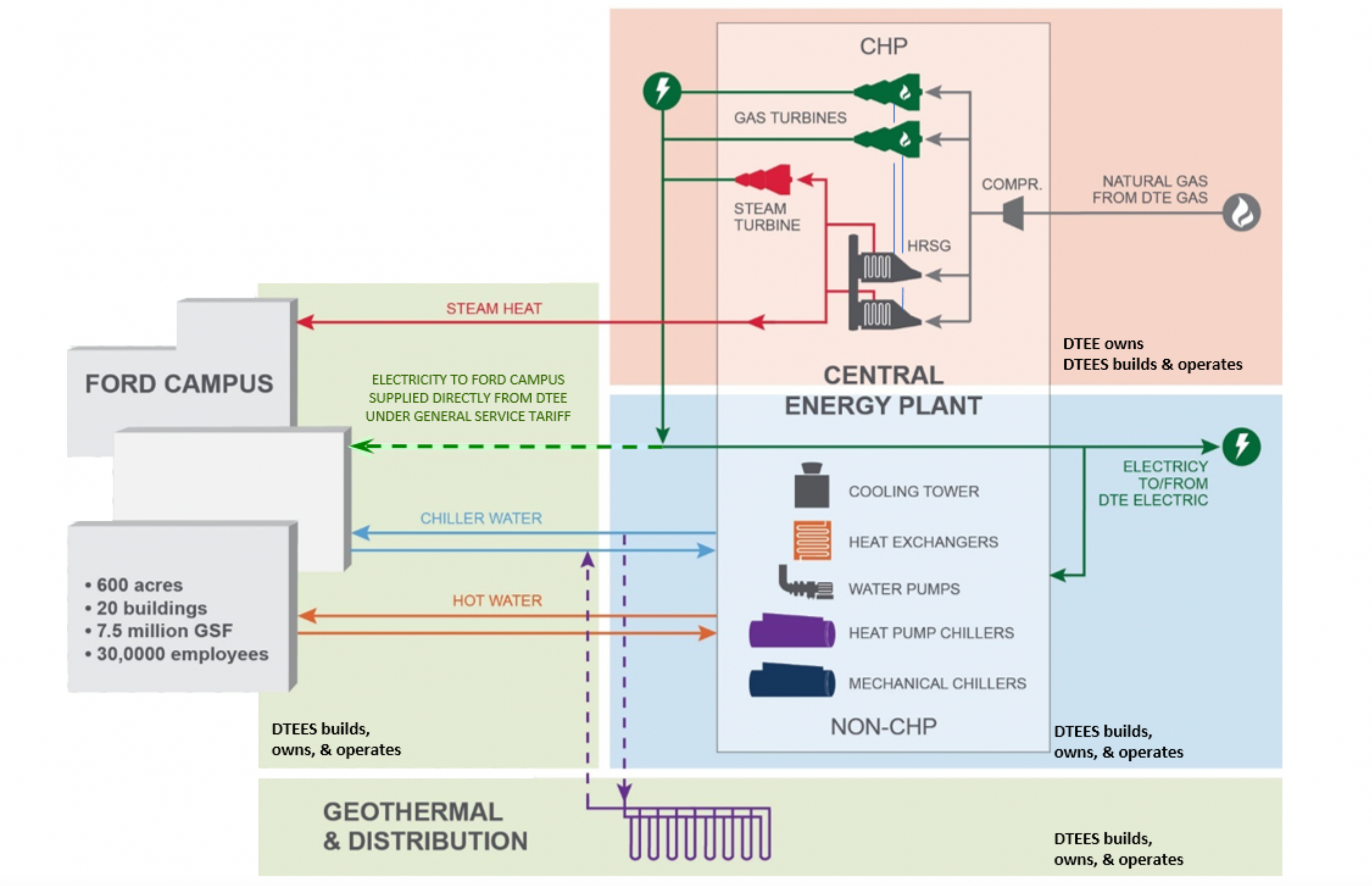

Take the case of the new CHP plant at Ford’s Dearborn, Michigan campus. It was originally specified at 23 MW to include two Solar Mars 100 gas turbines and a 3 MW condensing steam turbine. While this meant lower capital and operating costs, it didn’t allow for fluctuating steam and electricity requirements, or future expansion. In partnership with developer DTE Energy, Ford opted for a larger facility that could generate enough electricity to be sold externally.
A new design called for two 14.5 MW Solar Titan 130 gas turbines, a 5 MW condensing steam turbine from Siemens and Rentech HRSGs. The facility is designed to produce heating, steam and electricity for internal use as well as feeding the grid. The 34 MW, 370 k-lb/hr steam CHP plant offers enough steam load for Ford, and optimized sizing to provide electricity for the grid. Ford gains long-term contracts for steam and power from DTE as well as an on-site generation, greater energy efficiency and lowered emissions.

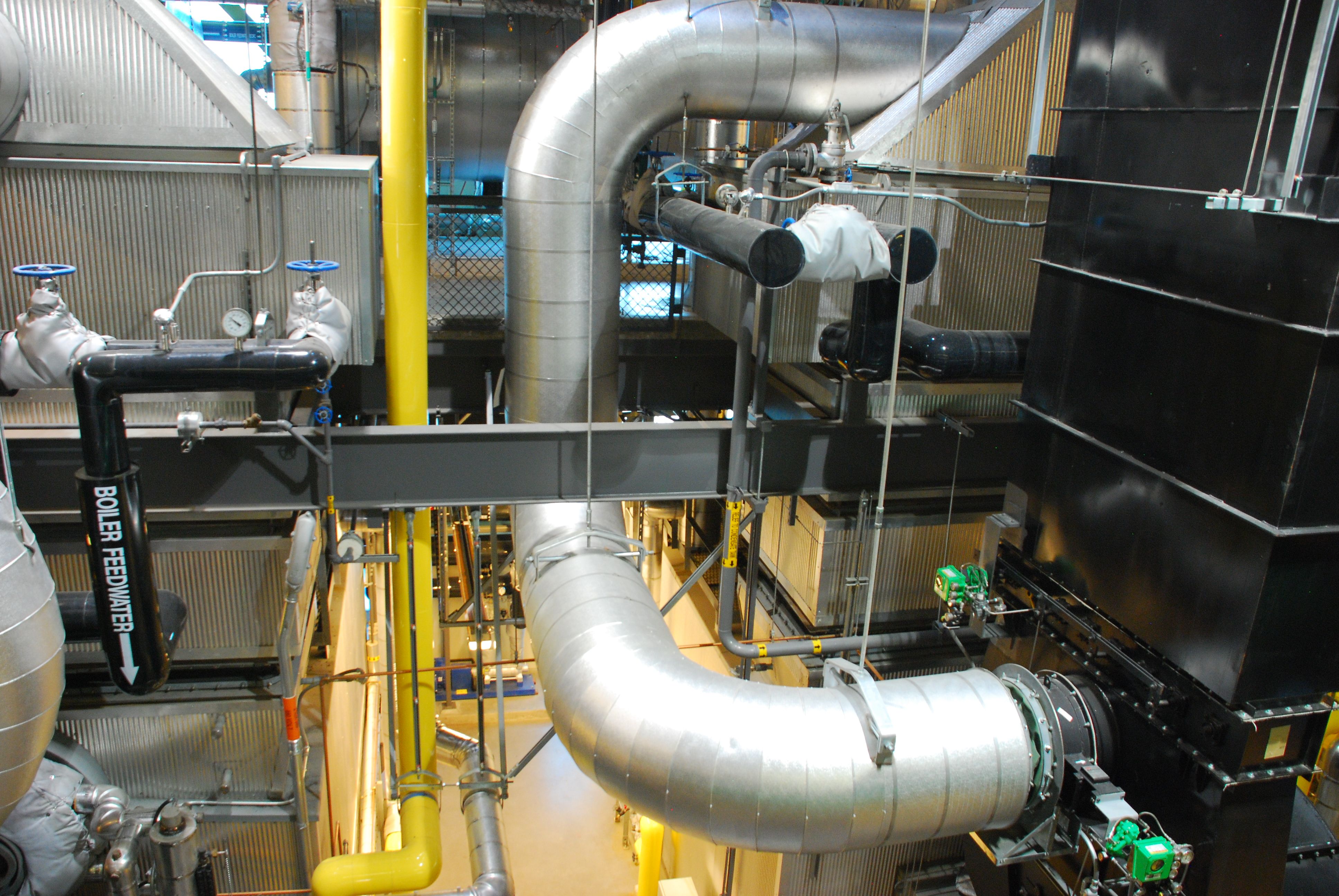

The reason for such gains is the evolution of technology. The latest generation of equipment comes with features such as SCR and LoNox burners integrated into the boiler. Modern designs lower the amount of refractory, so operators don’t need to worry about replacing refractory seals or rebuilding refractory walls. Additionally, placement of the superheater in the convection section protects it from hot exhaust gas, boosts reliability and extends lifespan.
Oregon State University (OSU), for example, replaced aging boilers with a CHP plant. The new facility consists of a combustion turbine from Solar Turbines, an HRSG, an Elliott steam turbine and two auxiliary boilers. This provides all the steam as well as half of the electrical needs of the 570-acre OSU campus located in Oregon.
The central steam plant hadn’t been upgraded since 1948. The replacement facility had to comply with Oregon’s State Energy Efficiency Design (SEED) i.e., exceed code efficiency requirements by at least 20%, and lower emissions. The campus uses absorption chillers, so there is little fluctuation in electricity demand throughout the year. Steam is used for heating, cooling and humidification the buildings, providing hot water, sterilizing greenhouse soil and lab experiments.
The new CHP facility consists of a 5.5 MW Solar Taurus 60 engine that can run on multiple fuels (natural gas, distillate, biodiesel or methane), a Rentech HRSG with a preheater, duct burners from R&V Engineering, two auxiliary package boilers with LoNOx burners, each capable of 85,000 lbs of 200 psig steam per hours, a 1 MW Elliott backpressure steam turbine generator, and an Emerson Delta V control system. The plant can produce up to 6.5 MW of electricity and up to 280,000 lbs. of steam per hour. By switching from utility to onsite power, the university estimated annual savings of more than half a million dollars.
