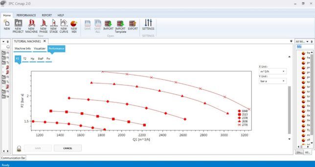

It should be noted that while the measurement of actual performances is quite straightforward, the evaluation of the design performance may be quite complex. In the case of centrifugal compressors, in order to perform a comparison between homogeneous values, the design performance needs to be adjusted to actual operative conditions. This adjustment step is not trivial and, as said, requires the availability of adequate computing tools. A complex machine aeromechanic and thermodynamic is necessary to get precise numerical results and allow a correct comparison with field measured parameters.
fig 1 screen shot Cmap[/caption]
Today, thanks to the diffusion of more powerful computational tools and machinery performance prediction software (as Camp software for centrifugal compressorsperformance), such complex machine modelling capabilities are available in the market and allow to implement diagnostic strategies based on the analysis of performance.
The introduction of the concept of performance evaluation within the machinery maintenance theme signifies also the irreversible step from qualitative evaluation to numerical and model-based methods, allowing the alignment of machinery maintenance to other departments such as engineering and operations. This process of integration is sometime called “Performance productive maintenance” and allows a projection into overall plant productivity.
The starting point of the method is the availability of a centrifugal compressor performance curve, the relevant gas mix composition, and thermodynamic conditions (pressure and temperature). Having this input data available, the software will perform all complex calculations in a fully automated way and will produce the expected compressor performances for inlet pressures, inlet temperatures and gas mix compositions for design/reference ones. It's possible to obtain a valid comparison term for the evaluation of compressor performance in actual conditions, referred here as expected performance. The method is compliant with the ASME PTC10 (Performance Test Code on Compressors and Exhausters) standard

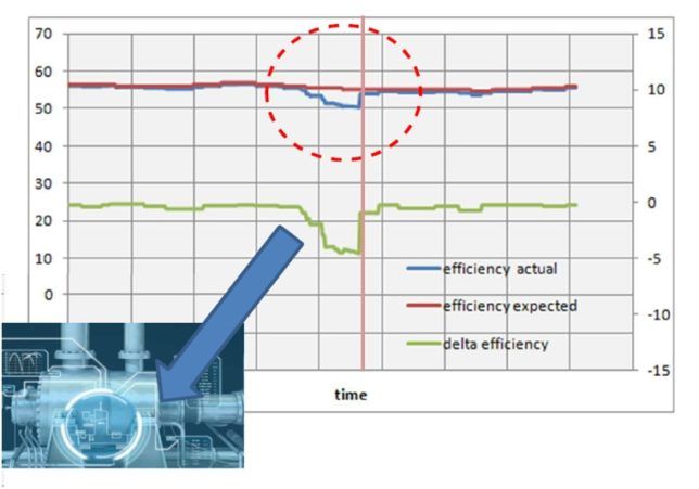

 5-A real case
In this paragraph a real case will be presented. A compressor was running largely under off-design inlet conditions. A performance-based monitoring system was implemented. The system included a calculation server devoted to run the machine model (CMapsoftware) to obtain the expected or “normal” performances in actual (off-design) conditions. PC/PLC based architecture allows to bring to machinery panel level all the computational power necessary to predict machinery behaviour as per OEM expectations and use this information to continuously evaluate the machinery healthy status.
Automated application of CMap can provide continuous monitoring of the machine performance and exert an automated surveillance and diagnostic. Also, the compressor protection from surge can be automatically and continuously updated to actual inlet conditions, overcoming limitation of actual systems.
The availability of expected performance allowed the comparison to measured field values and evaluation of performance deviation and degradation. The following picture shows a comparison of the actual efficiency to expected efficiency in actual condition. As previously mentioned, this parameter is a powerful indicator of compressor operative condition and healthy status: eventual deviation between expected and actual parameters is an indicator of the occurrence of malfunctions.
The same trends are available for discharge pressure, discharge temperature, polytropic head and power. Machine performance analysis can generate diagnostic advice on the nature of the possible failure directing the user towards some main defect areas such as mechanical, wear/fouling, and instrumentation.
