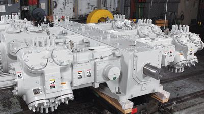

Reciprocating compressors of Dresser-Rand

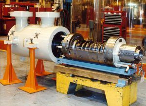

Reciprocating and centrifugal compressors of Dresser-Rand
Reciprocating and centrifugal compressors of Dresser-Rand[/caption]
