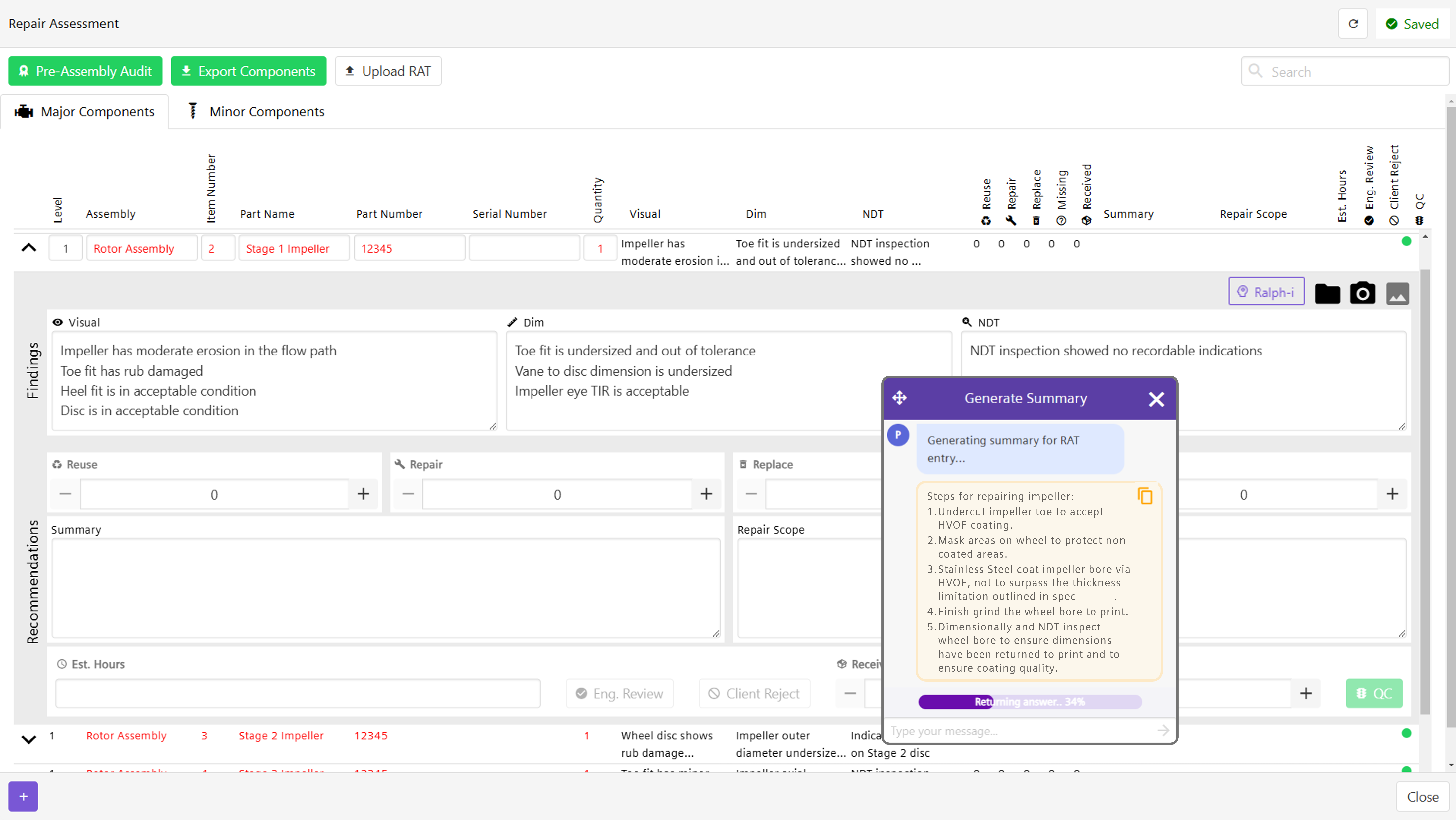

Automated inspection scripts customized for the specific type and model of machine being serviced extract key measurements from 3D scans. A scan of a first-stage impeller indicates measurements in and out of tolerance.
Measurements from the 3D scan are exported to a digital inspection platform for disposition, allowing technicians to analyze the unit directly from the shop floor in real time and eliminating the need for data processing offsite.
FIGURE 1 is a screenshot from the digital inspection platform showing how the scan results, along with data from manual procedures such as non-destructive testing (NDT), can be used to generate prescriptive repair recommendations using Gen AI. All the information is mapped to enterprise resource planning (ERP) and product lifecycle management (PLM) systems, which allows sales and repair personnel to provide faster and more accurate responses to customers on lead times and costs.
FIGURE 1: Digital inspection platform showing AI-generated repair summary from 3D laser scan and NDT results.
The entire process aims to reduce human error, improve repair consistency across service centers, and expedite compressor overhauls. These efforts have already yielded positive results. For many components, the time it takes to inspect, analyze, and determine necessary repairs has been reduced by more than 50%.

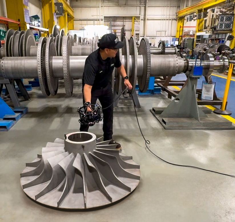

Extending digital inspection activities like 3D laser scanning to the field also benefits customers by enabling granular data collection and providing greater flexibility and adaptability in project execution. It may be possible to perform all work onsite for certain inspection activities, avoiding the need to ship machines or components to service centers.
Field scanning can even help address problems beyond the scope of compressor repair. In one example, a plant operator evaluated the drain line redesign during a compressor removal. Technicians scanned the existing configuration and quickly created a new piping isometric that eliminated the need to perform tack welds onsite.
In a separate field application, the operator was concerned about the bedplate leveling of their motor-driven compressor. Onsite scanning revealed that the motor, gearbox, and compressor pedestals were out of tolerance. Measurements from the scan were then provided to the customer to remedy the issue.
Using laser scanning to inspect a large open-faced impeller.
Laser scanning can be used to virtually assemble compressor components before physical assembly. Piecing digital scans together ensures that any potential fitment or interference issues are identified early on. Precision machining can occur before reassembly so that delays during the compressor overhaul or plant turnaround are avoided.
For example, digital preassembly and reassembly of a steam turbine spare rotor allowed a service center to ship components to an offsite machine shop on Day 2 of the turnaround. Had scanning not been used, this likely would have occurred on Day 7 or 8.
