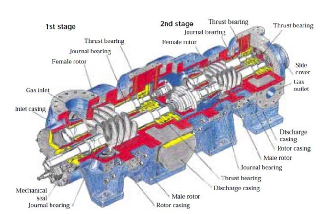

Construction of a tandem type compressor[/caption]
