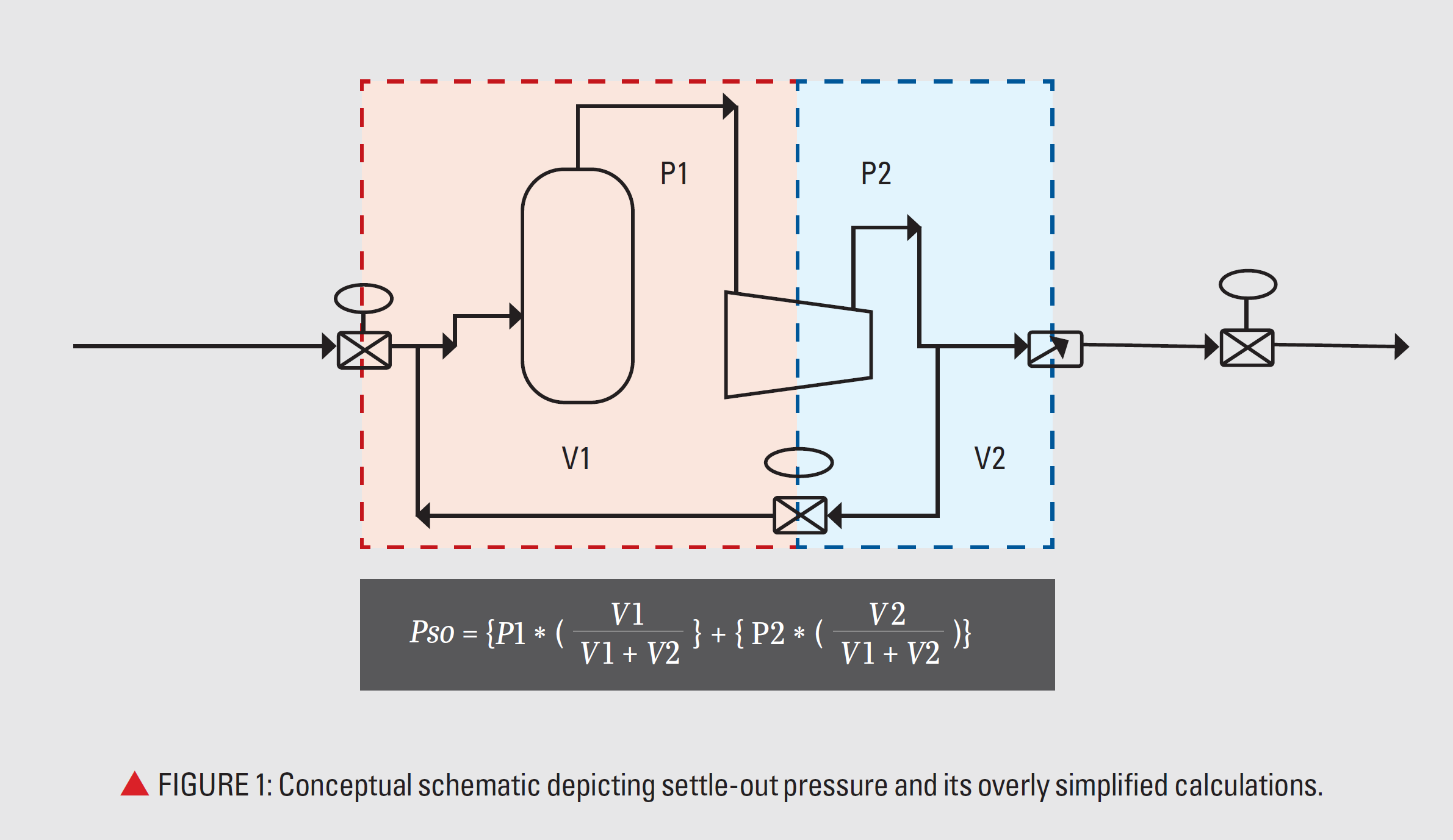

In a pressurized shutdown, the isolatable section is kept pressurized for restart, which results in pressure equalization across the compressor to SOP. This SOP is usually higher than the design inlet pressure and can reach values higher than the discharge pressure of lower or intermediate pressure sections, for example, of refrigeration compressors in LNG plants. FIGURE 1 is a conceptual schematic depicting SOP and its overly simplified calculation without considering the impact of temperatures.

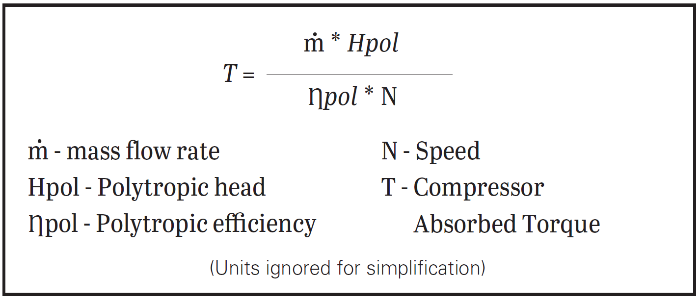

At restart, if the SOP is considerably higher than the design inlet pressure, the gas density and hence mass flow rate with full recycle through compressor are also high, requiring consider-ably high absorbed torque as in the equation below:
This is especially a concern as driver-produced torque is lower at reduced speeds. As the driver speed increases, it can pick up more load.
When plotted on a compressor map, these high-mass flow rates will show that the compressor runs in overload conditions that require high starting torque. In some cases, the driver torque may fall short of meeting the compressor-absorbed torque, which would impose reducing the SOP. Therefore, restart from SOP becomes an important design criterion while selecting the driver.
