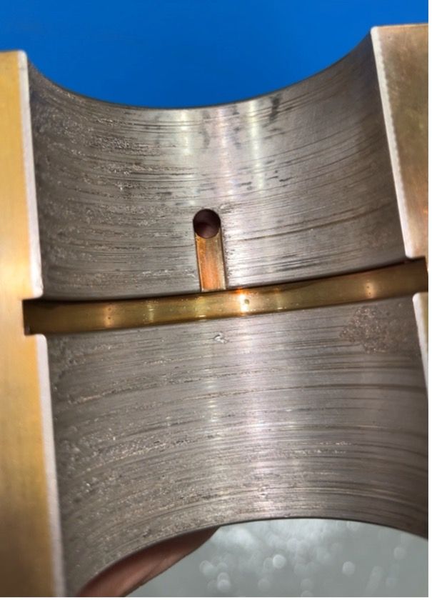

Steam Turbine Bearing Failure
A single-stage steam turbine, driving a transfer pump, underwent an overhaul. Following the overhaul, baseline vibration readings on the inboard bearing were at 1.36 mils and 0.9 mils (X & Y probes) at full load, which are considered acceptable. Two months later, however, during warming up at 900 rpm, the turbine tripped on a high-high setpoint of 3.6 mils. Could this have been prevented?
FIGURE 1 shows the increased linear vibration trend for this equipment. Considering the three detection methods mentioned earlier: The alarm and shutdown setpoints were not reached until the event, the operator did not observe this linear increase, and the failure happened between the vibration routes (the next vibration route was scheduled a month later). Such cases, albeit rare, tell us that a change in the monitoring strategy is needed—making it less human-dependent and more error-proof.

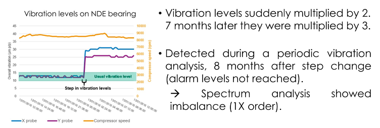

High-Cycle Impeller Failure of a Centrifugal Compressor
A second case study demonstrates centrifugal compressor failure.2 Two metal pieces were liberated from the impeller trailing edge at the hub side, in addition to consequential damages to diffuser vanes. The root cause was high-cycle fatigue related to running in a choke. What did the vibration tell us?
FIGURE 2 shows that the vibration levels (amplitude) were suddenly multiplied by 2, and seven months later they were multiplied by 3. The alarm setpoints were not reached, no operator observed the increase, and the changes were detected during a vibration route eight months after the first increase. Although the detection approach was somewhat proactive, since it was detected during a vibration route, it can be argued that it was late. Eight months of relatively high vibration without any observation or action raises concerns about the condition-monitoring strategy. Would detecting the increase earlier have helped? Perhaps. However, the key point is that failures may develop and go unnoticed, and as a result, they will worsen and cause prolonged downtime.

  1. Late detection: By the time a setpoint is reached, it might be too late—permanent damage might have occurred, e.g., in the first case study where the bearing was replaced and the bearing area had minor damages; in the second case study where the compressor impellers were damaged.

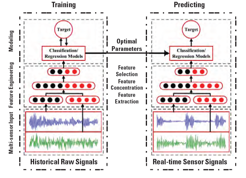

A data-driven approach to PdM is illustrated in FIGURE 3.6 The methodology can be broadly divided into four stages: A regression model is used to create a "predicted" signal, which is then compared against real-time data. Alerts are triggered when the deviation between the real and predicted signals exceeds a certain setpoint.

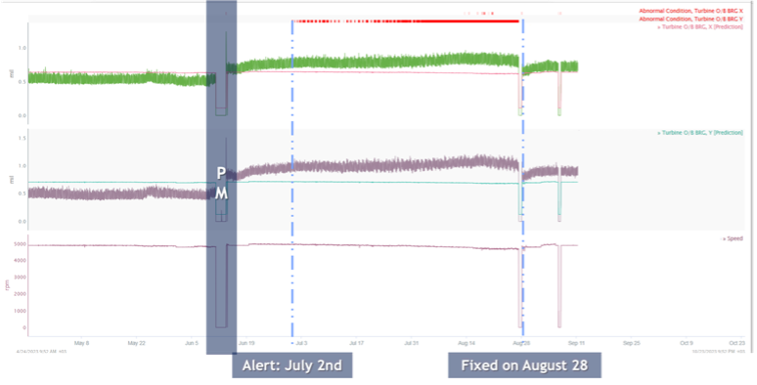

Detecting a Developing Anomaly at Early Stages
A developing abnormal condition was detected at an early stage. In FIGURE 5, the noisy signal is the real-vibration signal, whereas the stable one is the predicted signal. From left to right, the predicted and real signals almost matched at 0.5 mils until preventive maintenance was conducted during a shutdown period. Following that, the real signals started deviating, reaching 1 mil until an alert was generated on July 2. The area’s team was informed, and the issue was fixed during a planned shutdown window on Aug. 28. This shows the benefit of utilizing machine learning to detect slight increases in vibrations that are far below the alarm level where both operational needs and equipment health are met.

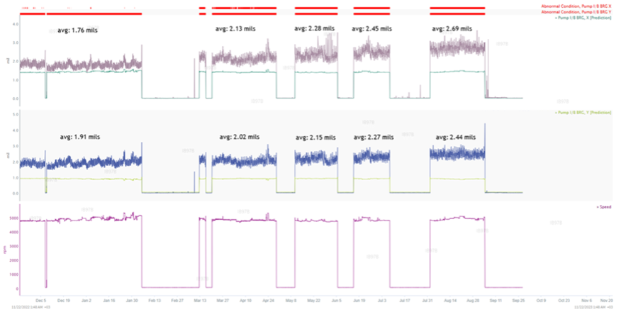

Detecting an Old Developing Anomaly
An old developing anomaly was discovered. When the model was applied to this equipment—a shipper centrifugal pump— high deviations were found between the real and predicted signal. In FIGURE 6, the noisy signal is the raw data whereas the stable one is the prediction model. Although the raw data show an increasing average over the year, indicating an actual issue, the discrepancies between the predicted and real signals are worth investigating. Generally, such discrepancies could be caused by selecting model features or physical issues with the asset.
Looking at the larger trend in FIGURE 7, the two signals matched two years ago until one probe experienced a step-change, followed by a step-change on the other probe. The vibrations continually increased linearly, albeit slowly, and remained below the alarm level. Operations were informed and a suitable shutdown window was selected for inspection. Had this not been detected, a sudden trip would have caused unplanned downtime.
