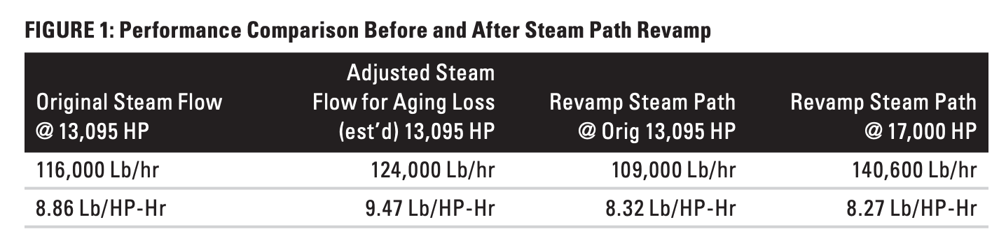

STEAM PATH REVAMP
Steam path revamps are an effective way to improve a steam turbine’s power, reliability, and efficiency.
With modern thermodynamic and mechanical design software, in certain cases, it is possible to pass more flow through a turbine and increase its rated output by simply changing the design of the first-stage blades and nozzle plate. Advanced 3D modeling software enables OEMs to implement new designs with greater predictability and fewer challenges, such as vibration. This capability is especially relevant today, with many customers opting for performance guarantees, particularly when it comes to uptime.
In one case study, upgrading multiple steam pathways increased the turbine’s rated power from 13,095 HP to 17,000 HP, in addition to a 6 - 7% efficiency improvement.
New steam paths utilize optimized airfoil designs, improved seals, and a fine-tuned aerodynamic match of stationary to rotating airfoils. Additionally, improvements to the mechanical components such as bearings, seals, and valve operating gear parts can lead to improved reliability.
One revamp to the Delaval 103-JAT is a conversion from a two- to three-wheel configuration. Original two-stage 103-JAT frames can generate around 11,000 HP. Converting to a three-stage design offers several advantages, including an approximate 6% increase in steam rate, higher reliability, and improved rotor dynamics due to thicker shafts and larger journal bearings. Original internals can be kept and used as spares.

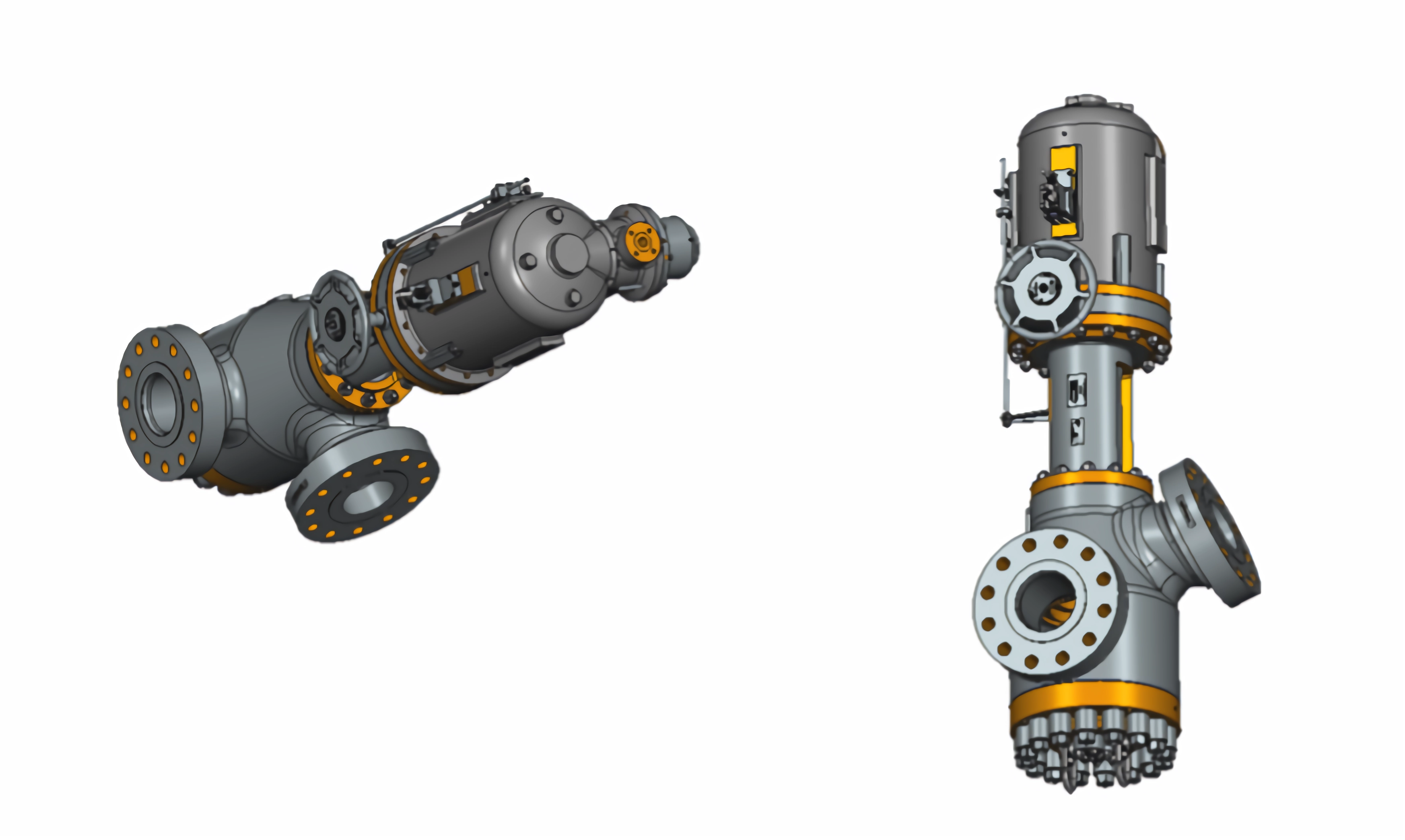

TRIP AND THROTTLE VALVES
One of the most challenging tasks for ammonia plants utilizing steam turbine drives for syngas compressors is to prevent a turbine overspeed triggered by designated turbine monitoring inputs.
Trip and throttle valves (TTVs) are designed to protect personnel and plant assets by rapidly stopping steam flow into the turbine. Many syngas trains today still utilize mechanical latch TTV technology, which was developed in the 1950s. While proven, past experiences overhauling TTVs have shown that many pressure boundary components, like cast valve bodies and yokes, are used well beyond their normal service life due to years of exposure to unknown pressure and temperature transients. Issues such as erosion, corrosion, and stress cracks have been discovered while performing non-destructive testing. These components can usually be repaired or replaced; however, lengthy and costly weld repairs or complete casting replacements can exceed new technology valve replacement costs and extend loss of production.
Siemens Energy’s Gimpel TTVs have been used on a wide range of OEM steam turbine frames since the 1950s. The top inlet Gimpel valves (TITTVs) on the Delaval 103-JAT steam turbine frame have always been challenging to replace. The mechanical latch design is outdated, and standard valve replacement options do not fit the available deck space.
Corrosion and contaminate build-up on TTVs are also problematic, as they can affect trip-time or full close of the valve. In most valve designs, spring compression is used to reset the TTV during partial stroke testing (PST) through direct mechanical movement via handwheel operation. The potential for spurious trips caused by the TTV during PST can lead some operators to avoid and/or delay recommended stroke testing (every 2 - 4 weeks), which presents a significant safety risk.
Improvements to the Gimpel TTV technology are continually made to address operational pain points and support the increasing demand for plant safety. Currently, Gimpel offers two types of modern valve replacements for TITTVs on Delaval 103-JAT frames, designed with unique steam section geometry to facilitate space constraints on existing deck arrangements.
Fully Oil-Operated TTVs (OOTTV). Designed for pull-to-close operation, OOTTVs utilize hydraulic oil pressure supplied by the turbine control oil system for valve reset and PST. With hydraulic operation, OOTTVs utilize a stronger closing spring for faster trip time (0.03 second versus 0.05 second for TITTV) and more accurate throttling at start-up. Both oil-operated trip valves (OOTVs) and OOTTVs are available depending on the turbine’s in-operation throttling requirements.
Electro-Hydraulic TTVs (EHTTV). Designed for pull-to-close or push-to-close operation, EHTTVs have a self-contained hydraulic system and a microprocessor-controlled electro-hydraulic actuator. EHTTVs close in 0.3 seconds or less and provide the most accurate turbine throttling on start-up. No turbine oil is required. The valves can be installed in any orientation based on the available space and are most adaptable for integration into a distributed control system.
Replacement of a mechanical latch TTV with one of these two options can yield a high return on investment. In recent years, Siemens Energy has executed numerous TTV replacements on ammonia syngas trains and received positive feedback from customers. Real-world experience has shown that, in many cases, the costs of installing new technology versus repair costs of a decades-old safety device provide a lower total cost of ownership and improved operational and performance benefits.
