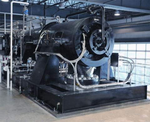

As compressor users look to maximize the production of their facilities or to reduce their operating costs, they often face choices whether to purchase new equipment or to upgrade their existing turbomachinery. Given the cost to build an entire new compressor train and its related support systems, it can, at times, be far more cost effective to refurbish existing equipment. However, there are limitations to what can be achieved via the so-called “revamp” or “re-rate.”

Limitations of re-rate: When an OEM is consulted regarding the rerate of an existing compressor, there are certain physical and mechanical constraints that can be checked quickly to determine whether or not a revamp is possible. These constraints limit the maximum performance capability of the machine. The physical constraints include the casing internal dimensions (i.e., length and diameter) and the nozzle sizes. The mechanical constraints include casing pressure and temperature ratings as well as any operating speed limits. If any of these constraints are exceeded by the re-rate requirements, the manufacturer will recommend replacing the compressor with a more suitable model.
