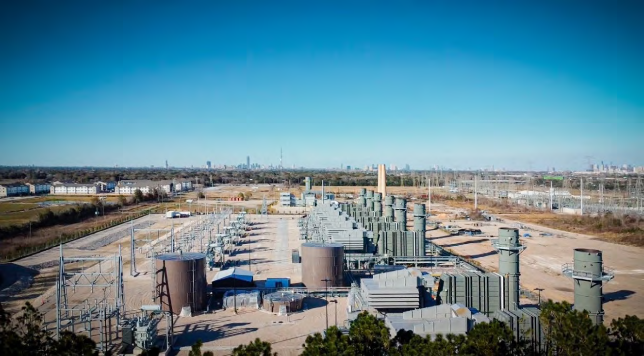

Figure 1: With six LM6000 units commissioned ahead of Winter Storm Uri by EPC contractor ProEnergy, the HO Clarke Generating Station generated continuous power to meet emergency capacity needs. Courtesy of ProEnergy.
Winter Storm Uri crippled infrastructure across the United States in February 2021. Texas was particularly hard hit: reports estimate that 69% of residents lost power and financial losses totaled $130 billion. No single generation type can take responsibility for the catastrophic blackouts. Instead, the least resilient facilities across all types of generation led to 60% less available capacity in the ERCOT market.
However, a new plant in Houston, Texas—a result of designing specifically for resilience—proved reliable in the historic storm. HO Clarke Generating Station (Figure 1) was created to meet the demands of typical Gulf Coast heat and increasingly common cold snaps. Owned by independent power producer (IPP) WattBridge, the plant leveraged a standardized design that enabled the 6xLM6000 facility to be commissioned two months ahead of schedule and fortuitously, a week before the storm began. The facility remained available throughout the weather event.

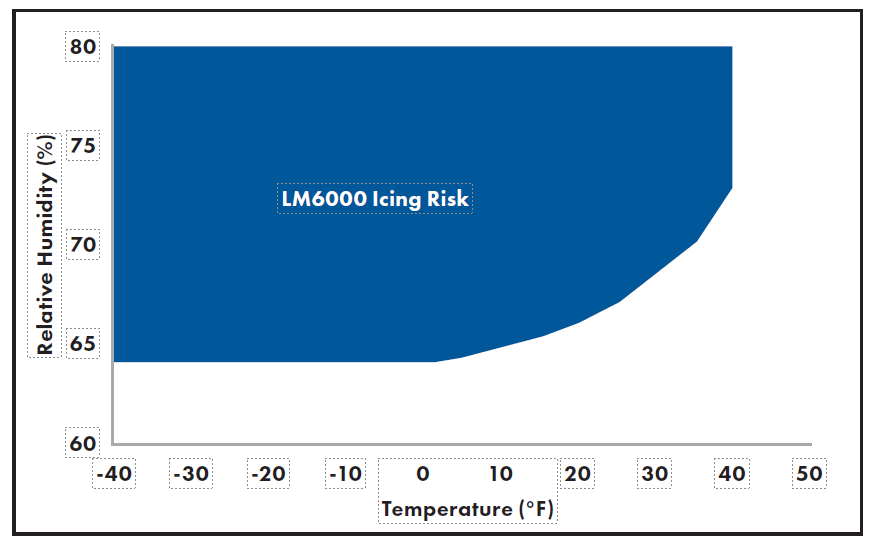

Figure 2: The LM6000 icing envelope puts power plants at risk below 40°F (4.4°C). Courtesy of ProEnergy.

In cold weather, the goal is keeping the facility online; a plant in Texas, however, will not require the same strategy as one in Minnesota. Anti-icing systems—traditionally overlooked in warmer climates—ensure sustained cold weather operation. Turbine icing begins at 40°F (4.4°C) (Figure 2), which means that most facilities in the world may experience icing at some point.

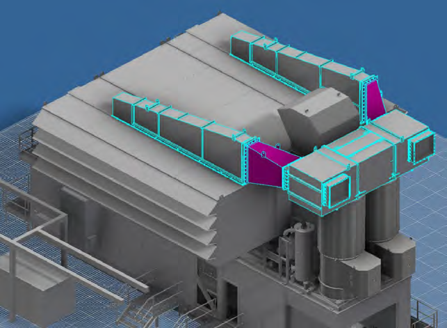

Though located in the warm Gulf Coast, the HO Clarke site is equipped with a package air recirculation system (Figure 3). It draws heated air from the engine compartment and recirculates it to the inlet air module. The system leverages waste heat from the turbine compartment and uses existing package exhaust fans to eliminate icing with minimal parasitic output losses.
Several other anti-icing technologies can be used to address turbine icing. These include compressor discharge pressure (CDP) bleed air recirculation, exhaust gas recirculation, and glycol heater and coil system. Regardless of the type of technology, any system only needs to raise the inlet air temperature by 5 to 10°F to eliminate icing risk.
Figure 3: The ProEnergy anti-icing system recirculates heated air from the engine compartment for zero parasitic losses. Courtesy of ProEnergy.

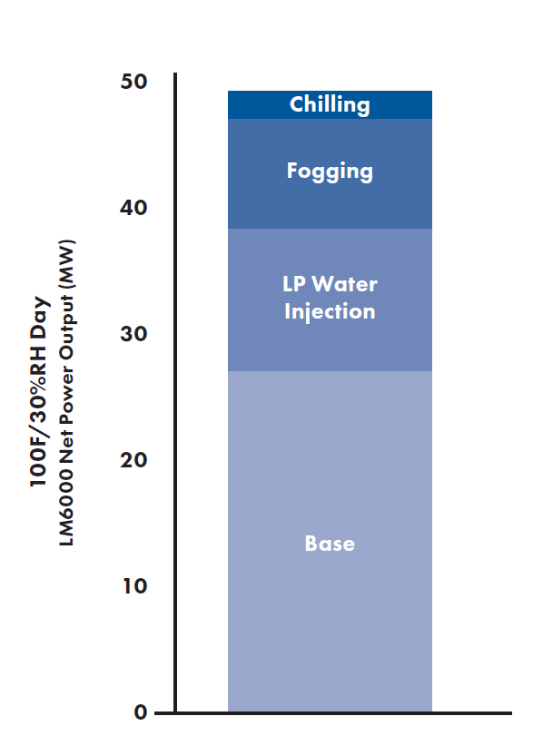

Turbine output is directly related to relative humidity and inversely related to temperature: as temperature increases, power output decreases. At 100°F (38°C) and 30% relative humidity, the base performance of an LM6000 engine degrades from 50 MW to approximately 27 MW (Figure 4). By implementing power augmentation strategies, such as low-pressure water-spray power augmentation, inlet fogging, evaporative cooling, and inlet chilling and coils, power can be returned to nameplate capacity.
Figure 4: Together, chilling, inlet fogging, and low-pressure water spray can augment LM6000 power to nameplate capacity despite high temperatures. Courtesy of ProEnergy.
Developers should carefully select power augmentation technologies to optimize the power benefit against CAPEX and OPEX. Factors to consider: Water-spray technologies and inlet fogging both require a consistent flow of demineralized water; evaporative cooling requires a separate, higher conductivity water feed, and causes increased static pressure on the turbine inlet, which results in efficiency loss; inlet chilling and coil systems tend to be both complex and costly. Given the annual number of hot Texas days combined with an ample supply of demineralized water, HO Clarke opted for water-spray augmentation and inlet fogging as the best way to maintain nameplate output.
