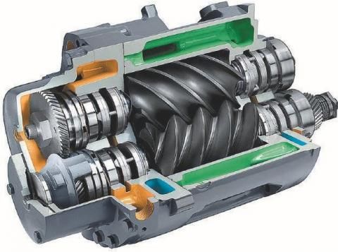

Screw compressor is called so as it contains two screws, one of them is driver mounted with prime mover (motor, turbine) and the other one is driven. According to the theory of operation, the two screws are mounted together by means of gears to rotate opposite to each other according to direction of rotation of driver (counter clockwise) squeezing the compressed air with oil in the compression zone to raise its pressure.
The compressed air is compressed with oil (flooded type) inside the compressor, and then the compressed oil and air are introduced to an oil separation unit to separate oil and air. Then the air is removed to the discharge line and oil is returned to the oil filter for filtration, then to the suction of compressor again. This type of compressor is characterized by large axial displacement during operation, at vibration measurement; the axial displacement of it is higher than any other compressor of different type.
Oil and screws
The function of oil inside the compressor is for lubrication of screws, bearings and seals during operation, and secondly, for cooling screws. As air compression rises temperature (thermodynamic process) and overheating affects screws badly and can cause localized thermal stresses in mid length of screw (hotspots). Over expansion of screws can lead to screw rubbing either with casing or with other screws but screws are manufactured from material of low thermal expansion to avoid overheating or expansion of screws due to bad lubrication or cooling.
