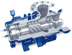

Cutaway of an oil-free screw compressor with dry gas mechanical seals[/caption]
A screw compressor is a twin-shaft rotary piston machine functioning on the principle of positive displacement combined with internal compression. The medium handled is conveyed from the suction port to the discharge port, entrapped in steadily diminishing spaces between the convolutions of the two helical rotors, being compressed up to the final internal pressure before it is released into the discharge nozzle.
