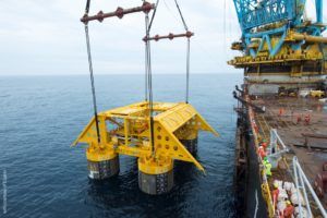

From installation summer 2013 Åsgard subsea factory with Saipem 7000.Subsea Compressor Manifold Station[/caption]
In 2015, Åsgard became the world’s first subsea gas compression facility to commence operation 300 meters below sea level – featuring two HOFIM motor- compressor units by MAN Energy Solutions Switzerland Ltd. The compressors have clocked 50,000 hours of operation successfully, according to the OEM. “In the early days we just had a few valves on the sea floor. Now there’s almost a complete factory down there,” explains Roald Sirevaag, Chief Engineer Subsea Technology of Equinor. “With Åsgard subsea gas compression, we are one step closer to realizing our vision of a subsea factory. MAN’s technology for subsea gas compression represents an essential factor for the successful operation of the Åsgard facility.”
