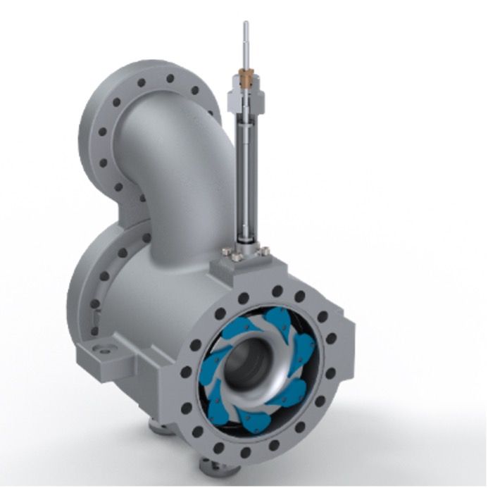

Manufacturers have encountered various issues that necessitated design and operational guideline improvements. Examples: Inlet guide vane mechanism and control; resonance-free impellers avoiding critical excitations; axial load increased capacity and control; and rotor-bearing system stability.
A turboexpander variable IGV works by converting a portion of process fluid head (i.e. 50%) to kinetic energy (gas velocity). Similar to an efficient control valve, the IGV maintains a desired process setpoint by regulating the volume flow through the expander. In general, IGVs allow efficient operation across wide operating ranges, while they must also be capable of high reliability in harsh process environments.
Basic aerodynamic design guidelines for IGV segments are uniform flow and pressure profile, balanced forces, no flow separation downstream of the throat, and minimizing the passing frequency wake region. Mechanical-related problems were formerly related to excessive force or contact stress applied to pins and linkage, and a clamping of the plates. These are nowadays evaluated during the design process phase, which takes into consideration the range of process pressures and the selection of the actuator size.
Most IGV problems are either: mechanical, such as galling; process-related, such as dust particles and process pulsation; or operation issues, such as actuator position hunting due to a fine control band. Galling wear results in damage to the sliding surface, which in turn causes adhesion and high friction. Nevertheless, IGV galling resistance has been improved by using materials with dissimilar properties, material treatments, minimizing contact stress between moving parts, avoiding deflection of the plates, and by applying suitable coatings compatible with the process media. Some of the process-related issues include stress corrosion cracking in case of sour gas, a high concentration of particulates, and hydrate formation when the hydrocarbon mixture contains water vapor. Operation-wise, IGVs are designed for continuous process control with desired control band bias.
However, in some instances an unnecessary very fine process control band setting results in a hunting of the actuator position. This shortens the life of some IGV components, particularly if some process contaminants are present. Currently, in addition to IGV assembly optimum linkage design, computational fluid dynamics (CFD), finite element analysis (FEA) and metallurgical analyses are carried out during the design phase. In addition, design and component integrity are validated using a stroke test apparatus developed for simulating the galling resistance under applied process pressure forces.

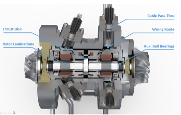

Rotor-bearing system
The selection of oil or magnetic bearings often comes down to the preference of the end-user. The decision is based on footprint, oil-free operation requirements, oil dilution in case of heavy components in the seal gas, and plant location.
The required load capacity for the shaft support, peripheral speed, process-induced cross-coupling effects, and stability is determined and set by analytical methods. The magnetic-bearing stiffness is about seven times lower than the equal-sized oil bearing, and for this reason larger relative magnetic-bearing sizes are used to compensate for the rotodynamic need. Turboexpanders with magnetic bearings have proven their rotodynamic robustness over several million hours of operation.
There have been several lessons learned from decades of design and operation of magnetic bearings. Two particularly worth highlighting are the importance of protecting the rotor-bearing system from external factors, such as corrosive components in the process gas; and choosing the right bearing size while taking into consideration the process parameter influence on the load capacity.

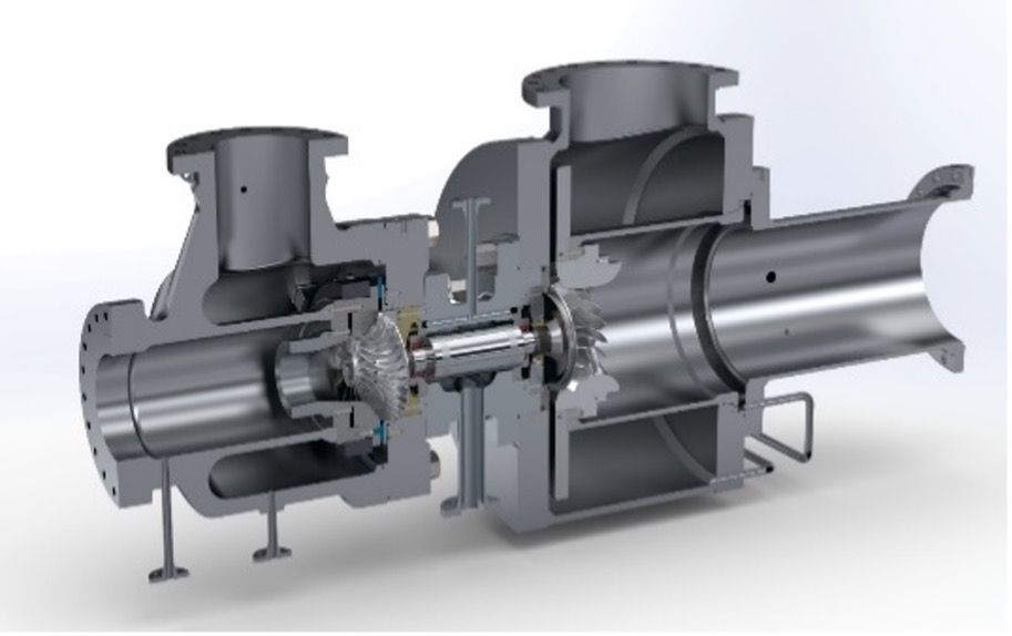

On oil-bearings machines, lubricant type, cleanness, and diluted oil viscosity after dissolve gas equilibrium are the important factors for reliability. Journal oil bearings could be either fixed geometry or tilted pad, depending on the peripheral speed. Turboexpander oil bearings are a combination of journal and thrust bearings with a positive automatic axial load control.
Turboexpander compressor shaft seals are a labyrinth type. The purpose of the shaft seal is to prevent process gas ingress to the bearing housing and to act as a shield against the cold process side. Warm and dry seal gas with positive differential pressure to the process side is injected into the seal and vented through the bearing housing to the lowest process gas pressure, which is normally the booster compressor suction. The bearing housing and the oil reservoir are pressurized, and the system is enclosed with no hazardous gas leaking to the atmosphere. For magnetic-bearing turboexpanders, shaft-seal clearances are two-to-three times larger than equivalent oil-lubricated machines due to higher bearing clearances. Therefore, in some applications, floating ring seals are used to minimize the seal gas flow rate.
