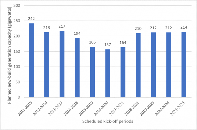

Figure 1: Top-line plans to build new generation. Source: Industrial Info Resources.
In aggregating planned construction kickoffs, all the planned construction activity won’t take place according to the developers’ schedule. In any given five-year period, roughly 30% of planned construction kickoffs will be cancelled or postponed; permitting issues, supply chain disruptions, regulatory decisions and inability to secure financing can reshape developers’ plans.
Approximately 80% of new-build generation scheduled to begin construction between 2021 and 2025 is expected to be renewables, mostly wind and solar (see map). Gas-fired generators will account for about 18% of new-build generation, with nuclear taking about 1% of the market.

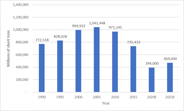

Figure 2: Consumption of coal by U.S. electric generators.
Source: Electric Power Monthly and Short-Term Energy Outlook reports, U.S. EIA.

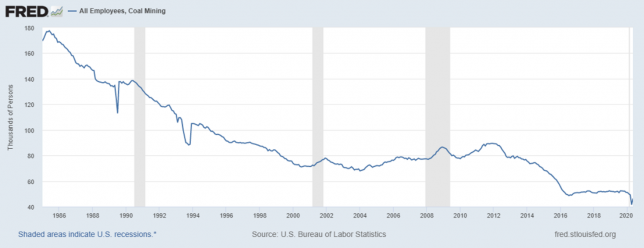

Longstanding trends like the decline in coal used to generate electricity (Figure 2) and the declining number of people working as coal miners (Figure 3) accelerated in 2020. Though coal use by electric generators is expected to increase a bit in 2021, there is little reason to think either trend will take a significant, longstanding positive turn over the next five years.
Figure 3: Coal mining employment.
Source: Federal Reserve Bank of St. Louis.

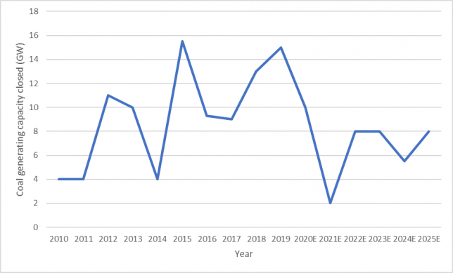

Roughly 94 GW of coal-fired generating capacity was retired between 2010 and 2019, and another 33 GW is scheduled to retire over the next five years (Figure 4).
During 2020, state-level integrated resource planning (IRP) processes at utilities from Portland, Oregon, Tucson, Arizona and Jacksonville, Florida, all came to the same conclusion: accelerate the reduction or elimination of coal-fired power. Continued low prices for natural gas as well as improved economics of renewable energy, coupled with regulators’ wish to see increased funding for conservation and energy-efficiency programs, all combined to squeeze the share of the power market served by coal.
Figure 4: Coal-fired generating capacity retirements.

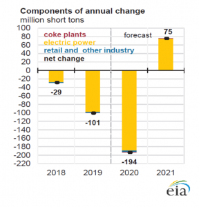

The U.S. Energy Information Administration (EIA) projects that the share of electricity produced by coal will fall from 24% in 2019 to about 18% in 2020 before rising to 21% in 2021. By contrast, coal accounted for nearly half of the electricity generated in the U.S. as recently as 2009. The EIA calculated demand for coal by electric generators would fall about 194 million short tons in 2020 from 2019 levels, but rise about 75 million short tons in 2021 (Figure 5).
Figure 5: Changes on demand for coal in the U.S. Source: EIA.

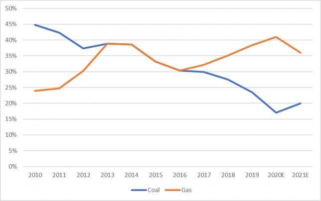

For much of the last decade, gas and coal have waged an intense fight for market share among electric generators, with gas taking an ever-larger share of the fuels market (Figure 6). But in 2020, as states like California and New York adopted ever-stricter renewable portfolio standards (RPS) and decarbonization plans, gas’ share of the market, estimated at about 40%, began to slip.
Figure 6: Coal vs. gas in U.S. electric power generation. Source: EIA.

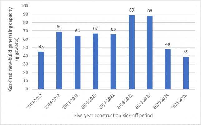

As shown in Figure 7, gas-fired power projects were all the rage for the 2018-2022 planned period, where four regions (Great Lakes, Northeast, Southwest and West Coast) each had plans to build between 10 GW and 20 GW of new gas-fired electric generation. Following a surge in the Southeast, where nearly 25,000 MW were planned to be constructed during the 2019-2023 period, new-build announcements have trended down sharply across the U.S. over the last two years.
Figure 7: Planned new-build gas-fired generation, by five-year period. Source: IIR.
Over the next five years, developers plan to build nearly 10 GW less gas-fired generation than they planned only a year ago: 39 GW in 2021-2025 vs. 48 GW in 2020-2024. As recently as 2018, developers had a five-year plan to build as much as 88 GW of gas-fired generation (Figure 8).

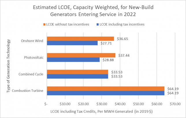

Increased efficiencies have made renewables like wind and solar increasingly competitive with gas-fired combined-cycle plants. The growing competitiveness of renewables was shown in the U.S. EIA 2020 Annual Energy Outlook, released in early 2020. Though recognizing that there were variances across regions, the agency’s estimated levelized cost of electricity (LCOE) for new-build generation showed that, when the effect of tax incentives was included, renewables had a lower LCOE than a new-build gas-fired, combined-cycle generator. But when the tax incentives were removed, combined-cycle generation had a LCOE that was several dollars less on a megawatt-hour basis than renewables (Figure 9). This particular estimate of LCOE from the EIA was for new-build generators that entered service in 2022, measured in 2019 dollars, on a capacity-weighted basis.
Figure 8: Plans to build new gas-fired generation fall sharply. Source: IIR.
Figure 9: Levelized cost of electricity for new-build plants entering service in 2022 (measured in 2019 dollars). Source: EIA.

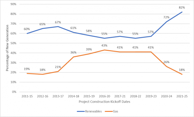

As shown in Figure 10, for all sorts of reasons, the dash to gas in the new-build generation market has slowed markedly from earlier years.
Figure 10: Proposed new build generation: Renewables vs. gas. Source: IIR.

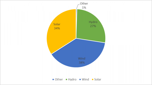

Figure 11 shows that wind, with a market share of about 38%, is expected to be the largest type of renewable generation built over the 2021-2025 period. That’s a reversion to the mean and a reversal from last year’s analysis, when solar was nearly double that of planned wind farm construction, 51% to 26%, in the new-build renewables market.
Figure 11: Market share of new-build renewable generation. Source: IIR.
Wind’s fortunes are benefitting from a late-2019 one-year extension of the federal Production Tax Credit (PTC) and an increase in its value. Prior to that extension, wind projects that began construction in 2019 were eligible for a federal tax credit of about one cent per kilowatt-hour (kWh) of energy produced. With the one-year extension due for expiration at the end of 2020, wind energy projects beginning construction in 2020 were eligible for a credit of 1.5 cents per kWh. The federal largesse led to a surge in wind energy project construction in 2020.
