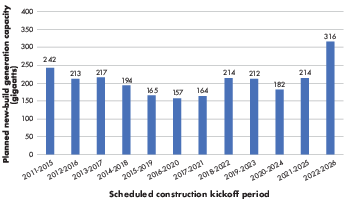

About 316,000 megawatts (MW) of new-build generation projects are being tracked with a scheduled construction start date between 2022 and 2026. Not all planned projects will be constructed according to their original schedules. Depending on the technologies involved, and developers’ ability to secure financing, offtake arrangements, and regulatory support, we typically see between one-quarter and one-half of all announced projects delayed or cancelled. But then again, new projects are announced on a near-daily basis.
While all 316,000 MW of new generation are not expected to be built as announced, the trend for the 2022-2026 period is clear and consistent with longstanding projections: cleaner and greener new-build generation.

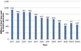

Generators that could switch fuels increased their use of coal in 2021, driving up coal use about 17% compared with 2020 (Figure 1). The EIA’s preliminary estimate of coal use in 2022 by power generators shows a decline of about 9% in 2022, as asset owners switch back to what they assume will be lower-cost gas. But as wave after wave of summer heat drove up electric demand, gas prices similarly went upward while coal stayed relatively flat. Could coal hold onto some of its newfound gains in the electric fuels market in 2022?

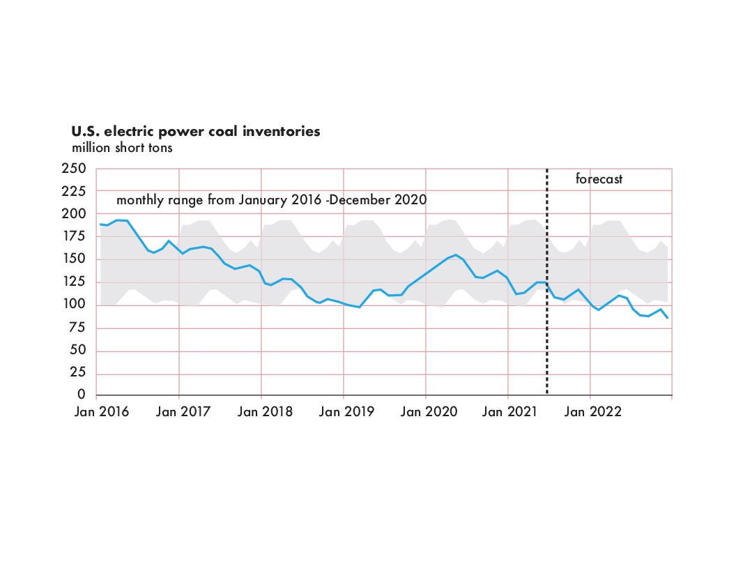

Electricity generators drew down on their coal inventories to meet rising demand, according to EIA estimates (Figure 2). Roughly 23% of U.S. electricity was generated by coal in 2021, up from 20% in 2020, the EIA said. In 2022, coal’s market share is expected to fall to 21%. Existing coal- and gas-fired generators continued their bare-knuckled fight in the electric fuels market, where a shift of a few pennies per MMBtu can cause generators to swing from one fuel to the other.

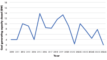

U.S. generators closed more than 100,000 MW of coal-fired generation between 2010 and 2020, and another 34,000 MW is expected to close during the next five years, according to data tracked by IIR (Figure 6). Though some states, like Wyoming, have tried to erect legal barriers to the closure of coal mines and coal-fired power plants, most observers don’t think those laws will be upheld by the courts. Economics more than laws will determine the future of coal and coal-fired generation in the U.S.
Over the 2022-2026 period, construction is unlikely to begin on any new-build coal-fired power plants. Capital spending at coal generators will be for environmental remediation, particularly cleaning up coal ash ponds, and in-plant capital improvements like turbine upgrades.

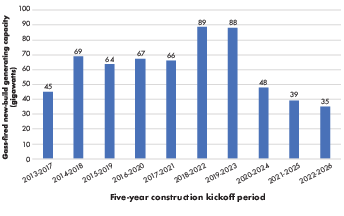

Construction on about 35,000 MW of new-build natural gas-fired generators is expected to start during the 2022-2026 period. That’s about 11% of the 316,000 MW of new generation that developers plan to begin building during that fiveyear timeframe (Figure 7). The areas with the greatest amount of planned new-build gas generation are the Great Lakes, the Mid-Atlantic, the Southwest, the Rocky Mountains, and the Northeast. Very little new gas generation is scheduled to be built in the Southeast, Midwest, or West Coast.
Developers and asset owners who have delayed or cancelled gas-fired, newbuild generation typically cite “market forces” as the reason for their decision. That covers a wide range of factors, including an inability to obtain financing, reach offtake agreements, or secure transmission rights. As gas pipelines start to run into opposition, stymied gas pipeline projects like the Atlantic Coast Pipeline are another market force with which developers have to contend. Finally, another powerful market force is a state’s regulatory regime, and several have turned against gas in recent years.
Renewables will continue to constitute the overwhelming majority of new-build U.S. electric generation projects.
That’s certainly the case in California, Arizona and New York, where state commitments to reduce greenhouse gas emissions in the electric sector or increase the percentage of renewable energy in the electric mix work against gas. In addition, methane emissions have emerged as another market force working against natural gas generation. Methane is a much more potent greenhouse gas than carbon dioxide, at least over the short term.
The cancellation or delay of approximately 48 new-build gas-fired power plants has been documented in 25 states that were scheduled to begin construction in 2021. The total investment value of those plants was about $12.6 billion. As more states, and possibly the federal government, enact measures that cut against gas-fired generation, the number of new-build generation projects should continue to decline over the 2022-2026 period.
About 35,000 MW of new-build gas-fired generation is scheduled to begin construction between 2022 and 2026. That is down a little over 10% from last year’s five-year tally and about 60% less than what was planned to kick off construction during the 2019-2023 period.

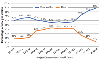

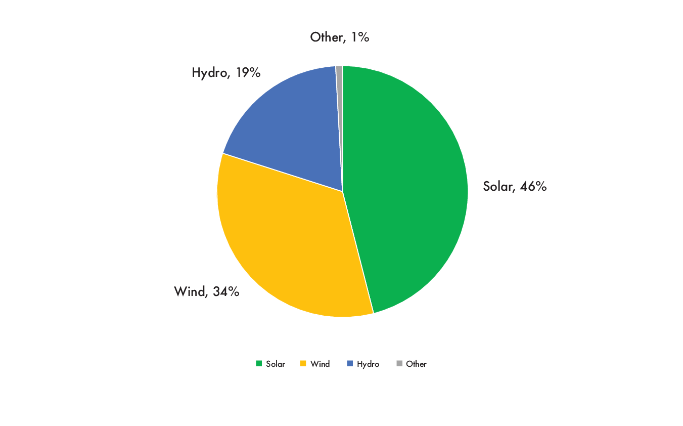

Gas’ loss has been renewables’ gain. Renewables are now projected to account for about 88% of all U.S. new-build generation capacity over the 2022- 2026 period, roughly eight times the amount of gas-fired generation scheduled to be built over that time (Figure 9). That gap has widened over time. In 2018 looking at a five-year construction cycle between 2019 and 2023, renewables were scheduled to account for about 57% of all new-build generation scheduled to be built in the U.S compared with 41% for gas. But renewables’ improving cost competitiveness stemming from efficiency gains, coupled with a growing embrace by regulators and Corporate America, has widened its lead in the new-build race.
Over the next five years, solar is expected to surpass wind for the first time in utility-scale renewable energy construction (Figure 10). The widespread popularity of rooftop solar, both for residential and commercial settings, is not reflected in Figure 10, so the growing popularity of rooftop solar likely would give that energy source an even larger slice of the renewables’ pie.
About 1,450 renewable energy projects are scheduled to begin construction over the next five years. Those projects have a total investment value of about $390 billion.
Again, all of those projects are unlikely to begin construction as scheduled. But over the next five years, the new-build renewable power business looks particularly green in the Rocky Mountains, the Southwest, the Great Lakes and the West Coast (Figure 11).

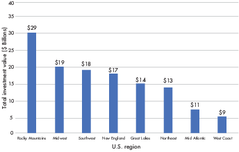

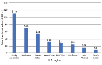

Nevada and Arizona are the states in the Rocky Mountain region with the largest dollar value of solar projects under development. In the Southwest, solar project activity is taking place almost exclusively in Texas. The Great Lakes region also has a robust pipeline of solar projects being developed, with Ohio and Indiana in the lead, followed by Kentucky and Illinois, according to project data being tracked.
Although fewer wind projects are being developed than in prior years, mostly because the areas with the best quality wind resource already have been tapped, the Rockies, Midwest, Southwest and New England are the regions with the largest dollar-value of wind power projects scheduled to begin construction between January 2022 and December 2026 (Figure 12). The Rockies, Wyoming, New Mexico, and Arizona are the regions and states with the largest dollar value of wind projects under development, according to data tracked.
The $390 billion of renewable energy projects under development include 27 offshore wind projects valued at about $39 billion. The Atlantic Ocean is far and away the leading body of water for proposed offshore wind power projects. The Biden administration wants to see as much as 30 gigawatts (GW) of offshore wind power developed in the Atlantic Ocean by 2030.

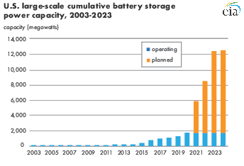

About 3.5 GW of battery energy storage that will become operational in 2021 is being tracked, an 80% increase over the capacity that began operating in 2020. Another 4.3 GW of BESS capacity is slated to come online in the U.S. by the end of 2022. The West Coast and Southwest are the regions with the highest level of project activity for BESS.
