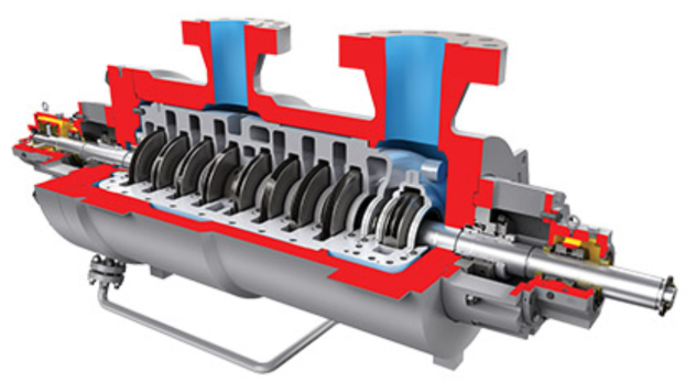

A high energy pump at a water injection station in El Furrial, Venezuela exhibited extremely high vibration levels prior to an overhaul. It then suffered a catastrophic failure during startup following overhaul. The hydrodynamic bundle, rotor, and drive end (DE) bearing suffered damage.
High energy pump for boiler feed water. Courtesy of Flowserve.
This centrifugal pump is a 3,000 HP, double-case volute, boiler feed water pump type. It has nine stages, outputs 750 gpm of water with suction pressure 1800 psi and discharge pressure 5250 psi. Rated speed was increased from 6000 to 6600 RPM to enhance the hydraulic performance. However, the pump’s actual discharge pressure was about 4,500 psi, well below the target value of 5,000 psi. The coupling was reportedly poorly fitted.

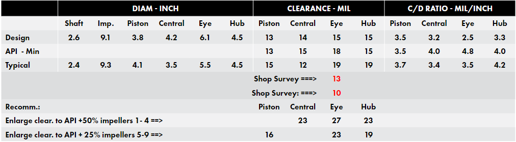

A thorough study of internal clearances was conducted. Table 1 shows the results from this study featuring a comparison between internal (hydrodynamic bundle) clearances from different data sources, namely: design data, shop measurements, API-610 minimum clearances, and typical clearances for a similar pump with vibratory problems. As a result, the recommended clearance for the center seal, balance piston, eye, and impeller hub seals are shown in the bottom part of Table 1.

Table 1: Analysis of internal clearances.

The most likely cause of failure was attributable to tight clearances found in the hydrodynamic bundle’s internal seals. OEM design and even API clearances were considered to be too tight. Reducing internal clearances below API 610 recommendations exposes these pumps to catastrophic failures during start up. For the impeller eye, we recommend a 50% increase (to 27 mil) over API values for stages 1–4 and a 25% increase (to 23 mil) for stages 5–9. Clearances for other rotor locations are shown in Table 1.
