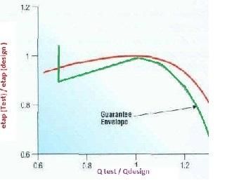

The curve plotting shall be more accurate if the number of test points at the same normalized speed is a minimum five. To have a realistic and close predicted shape of H-Q curve, cubic fitting should be exercised in curve plotter. To calculate the slope of a curve, the derivative of the curve's function is to be calculated. There are several methods for calculating the derivative, but the power rule is the simplest method and can be used for most basic polynomial equations.
It is advised that predicted and tested compressor performance curve should be non-dimensional so that property of impeller aero-thermodynamic performance is easily validated, or test procedure shall show a guarantee window.
