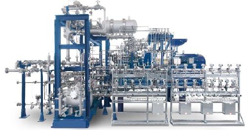

Flare gas recovery is a growing application due to the increasing desire to recover all energy sources, as well as increasing restrictions on emissions and flaring. The challenge for a flare gas compressor is to be able to handle varying molecular weights and inlet pressures as the makeup and supply of flare gas changes over time. This is one of the strong areas for a screw compressor – the positive displacement principle means that it is generally insensitive to changing inlet conditions, and the robust nature of the stiff rotor design combined with few moving parts makes it well able to handle occasional upset conditions.
Two stage oil free screw compressor system for flare gas recovery[/caption]

With the screw compressor it is interesting to note that if the mole weight of the flare gas varies between 10 and 30, as long as the volumetric flow rate remains constant, the brake horsepower also remains nearly constant. Flare gas applications often need to maintain either a constant inlet pressure to support the upstream system or a constant discharge pressure to the downstream users.
A screw compressor is well suited to either case. For an oil-flooded screw compressor, an internal slide valve can be used for capacity control without varying the operating speed.
Oil-free screw compressors are also used in this service, and in these cases a VFD or recycle line are used for capacity control. If an oil-flooded screw compressor is used in this application, the oil will be in contact with the gas, and thus must be selected based on compatibility with the gas components.
Oil-free screw compressors are less susceptible to issues related to gas composition, and as long as the gas is above the dew point (as is true most of the time with oil-free screw compressors), there is little risk to the materials of the compressor.
