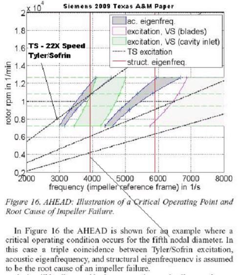

The two papers give analytical and confirming test results for two actual high-pressure compressor cases where modes of failed impellers were resonant at harmonics of stationary vanes – not at rotating blade passing frequency. It was concluded there was resonance for 17 bladed impellers, 5-diameter disk mode with resonance at 22 times speed from downstream vanes, along with side cavity acoustic 5-diameter mode at 17 per rev resonance deemed to cause a failure. The fix for both cases was to change number of stationary vanes, from 22 to 25 for Case A and from 22 to 19 for Case B. For both modifications disk modes did not change and blade passing frequency remained the same, leaving the number of impeller blades at 17.
Marked-up figure from the 2009 Siemens paper below shows triple coincidence:
1. Tyler/Sofrin mode with 5-diameter as 22-17 = 5
2. 5-Diameter Disk Mode at 22 X speed
3. Acoustic mode with 5 diameters = 17X
In summary, coupling of matching modes, acoustic and structural, is necessary at traveling wave resonance at operating speed. A triple coincidence is needed, the same structural and acoustic mode, along with the correct number of stationary vanes for Tyler / Sofrin spinning acoustic modes.
