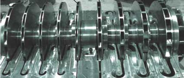

Figure 1: New compressor rotor assembly. Courtesy of Siemens/Dresser Rand.[/caption]
Compressor configuration
The configuration for the new compressor is a back-to-back rotor with five and four impellers per stage, similar to Figure 1. The technology improvements observed in the new design rely on several factors. Mathematical modeling and CFD tools were used to develop an improved aerodynamic 3D design for the impellers with high flow coefficients allows a more appropriate profile in the vanes. This is especially useful in the configuration of the first two impellers.

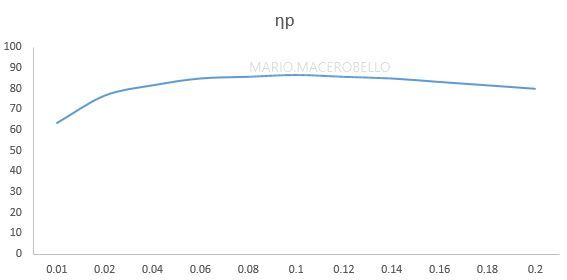

Flow coefficients for compressors typically range from 0.01 to 0.16. The first stage impeller of the new compressor train has a flow coefficient of 0.09. At the second stage, the flow coefficient drops to 0.02, which limits the efficiency in the second stage below 80 % as a consequence of density changes in the first stage (Figure 2).

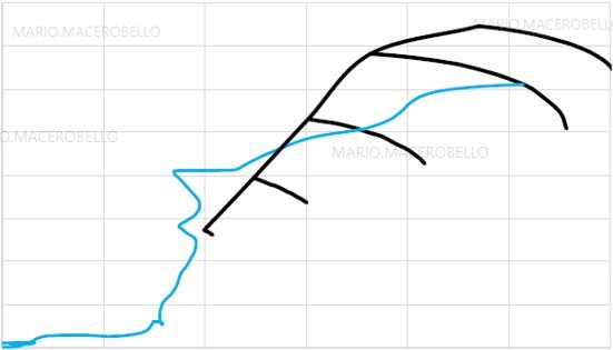

Figure 3: First stage behavior during shutdown without depressurization.[/caption]
Anti-surge system

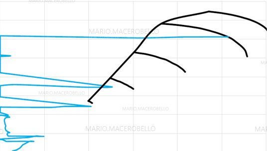

A dynamic analysis was performed to assess the system needed to prevent surge (Figure 3). Many factors were discovered which impacted the selection of the antisurge system. Aggressive reverse flow was discovered that derived from a high-pressure ratio (10-1) in the first stage. Additional reverse flow was found at the discharge side of the first stage once the second stage antisurge valve diverted the gas to the suction side. Further, sudden pressurization at the first stage suction prevented activation of the pressure relief valve during emergency shutdown. Blow off valves were installed at the discharge sides of the stages to depressurize and prevent damage in the compressor, static equipment and pipes located at the compressor suction side (Figure 4).
