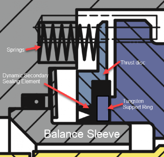

With secondary sealing elements managed, another concern is the dynamic secondary sealing system (Figure 2). This system allows the non-rotating seal ring to move axially and maintain an effective gap between the seal ring faces. The major components in the dynamic secondary sealing system are the dynamic sealing element and the balance sleeve.
When pressure is applied to the balance sleeve, the sleeve diameter shrinks. This increases the clearance between the seal ring inner diameter and sleeve. A balance sleeve that changes minimally as extreme forces are applied prevents extrusion from occurring. Using a material with high compressive strength such as tungsten carbide minimizes these changes in balance diameter.
Figure 2: Dynamic secondary sealing system.

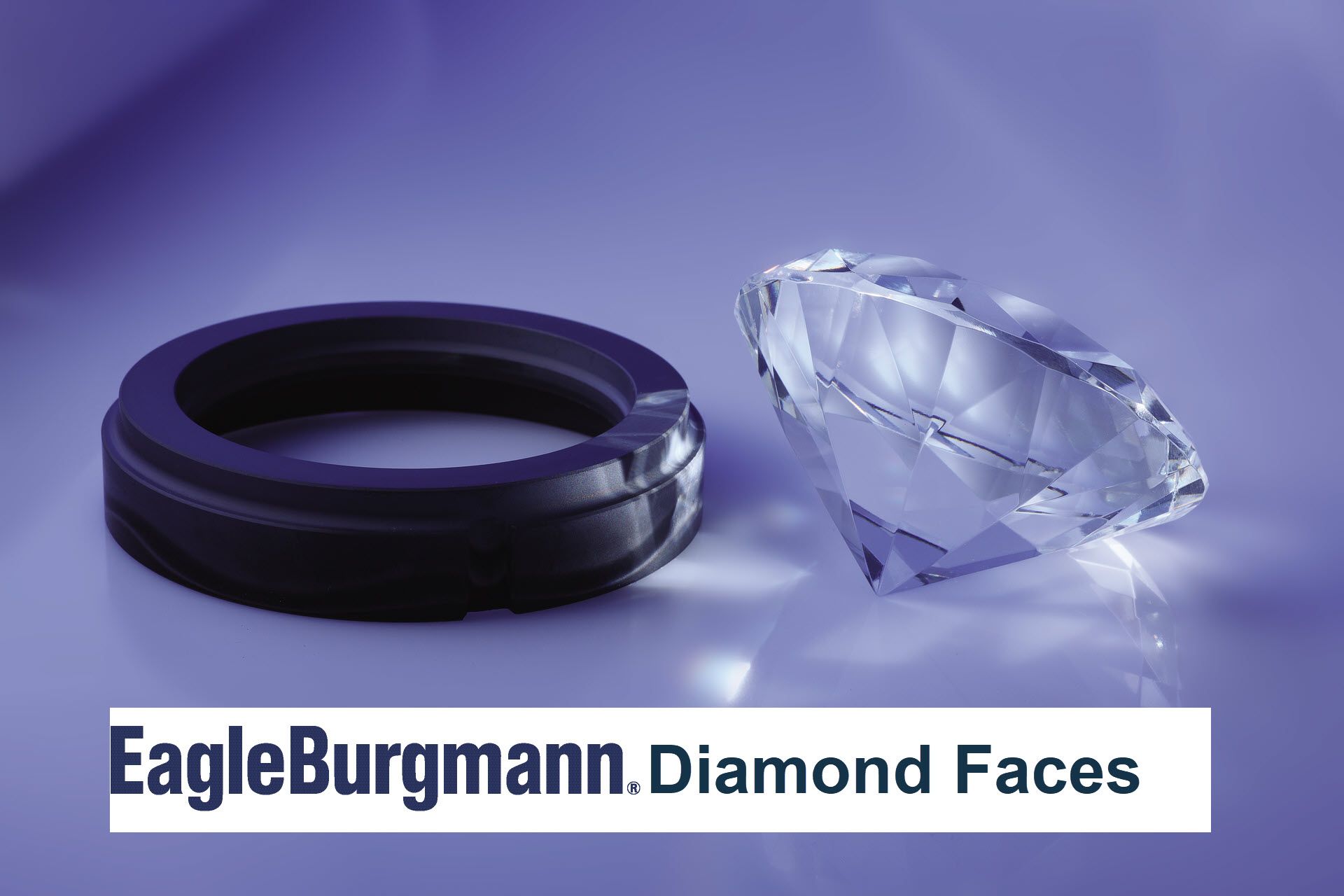

It is detrimental to operate any mechanical seal with no sealing media between the seal ring faces. This causes face contact and leads to a seal failure. Pumps in tank farms are often run dry for extended periods and these seals continuously fail. To manage this problem, a process was developed to grow a layer of diamond on seal ring faces. This layer greatly increases pump seal life. This same technology was applied to dry gas seals to manage face contact.
Dry gas seal ring faces are in contact when inadequate pressure is applied to the seal rings or when a compressor is rotated at speeds below 500 rpm. When a ratcheted compressor or one operating on a turning gear are operated, no seal gap is produced or the sealing media is absent between the seal faces. This leads to contact operating modes.
Even when the compressor is pressurized, the secondary seal still has the possibility of insufficient pressure, leading to face contact. For silicon carbide seal rings, diamond-like carbon (DLC) is applied to the faces. This permits contact operation for small time increments. Seal rings made of tungsten and carbon graphite are more forgiving and can operate for longer periods in contact. The downside to this combination is that the carbon graphite face wears as contact occurs, producing carbon dust. When in contact with dry nitrogen, the graphite face wears even quicker and generates more carbon dust. This has some impact on the flatness of the seal ring face, and negatively impacts seal reliability. The dust collects in the grooves and around the dynamic sealing element, contributing to premature failure.
To effectively manage long periods of face contact, a diamond coating is applied to the seal ring faces (Figure 3). This increases seal life due to its hardness, low friction coefficient and heat dissipation. These traits prevent any detrimental effects when seal ring faces operate in contact.
Figure 3: Diamond-coated seal ring.

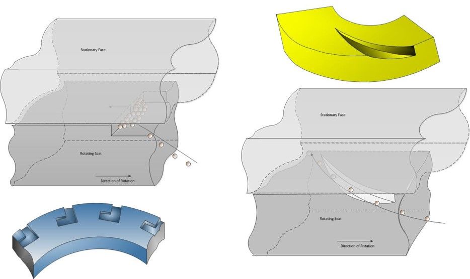

Dry gas seals typically have unidirectional spiral grooves. Manufacturers have identified the spiral groove as the best for producing a stiff gas film to prevent contact between seal ring faces. Through finite element analysis and programming developed to determine how groove geometry effects seal leakage and gap generation, a bidirectional groove has been developed. It produces the lowest leakage, with the higher film stiffness and reliability. If a compressor has been turned backwards inadvertently, this can damage or destroy unidirectional seals. A bidirectional seal eliminates this concern.

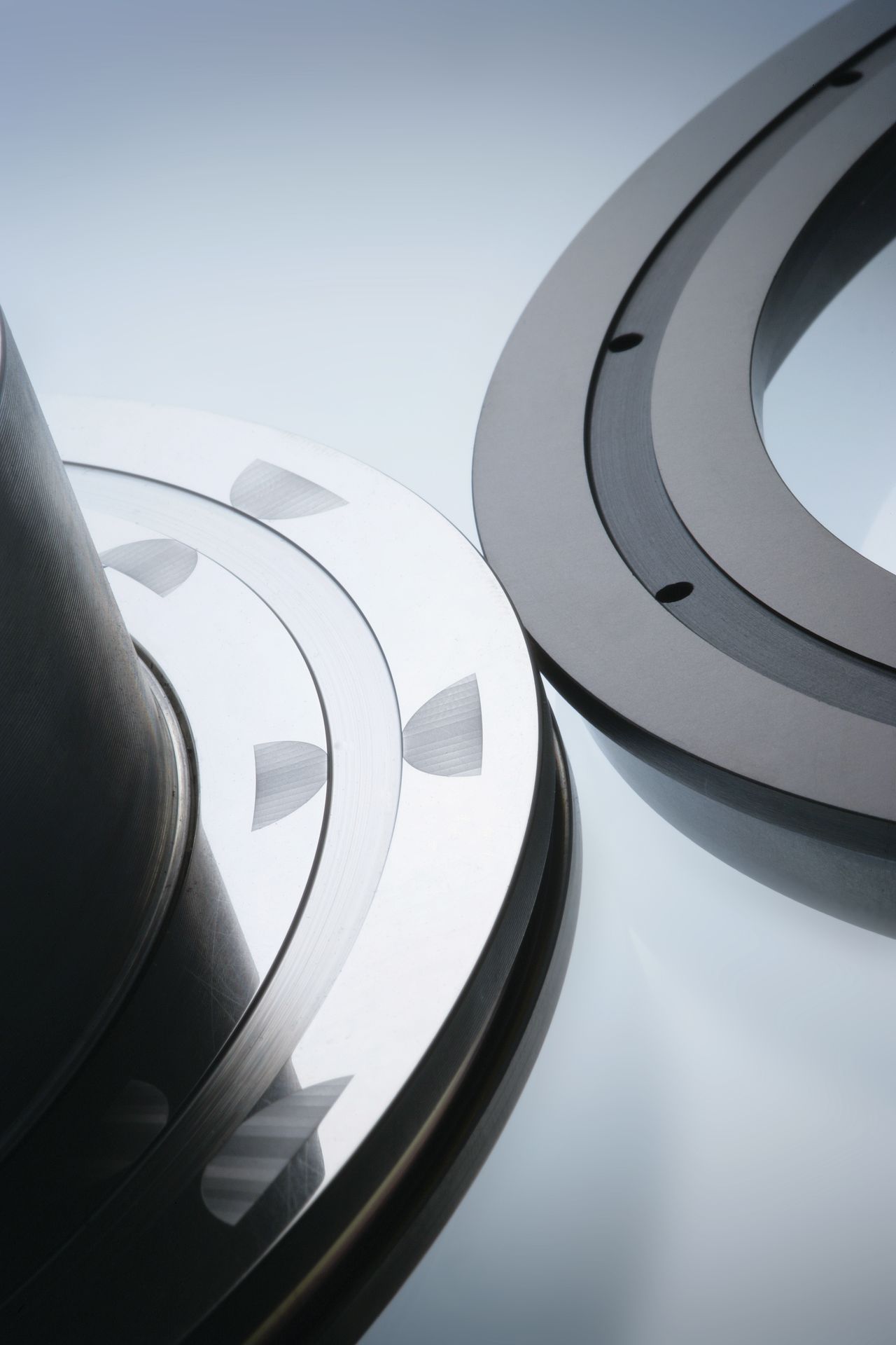

A 2-dimensional groove formed in the seal face is the most common profile used in the industry (Figure 4). This produces an edge around the groove that traps debris. As debris builds, the groove becomes ineffective at producing a sufficient gap and gas film stiffness. A 3-dimensional groove with an angled groove profile, on the other hand, allows debris to flow through it without impacting groove effectiveness.
Figure 4: Grooves in a rotating, two-dimensional ring.
