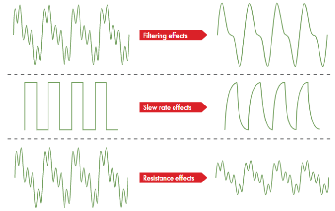

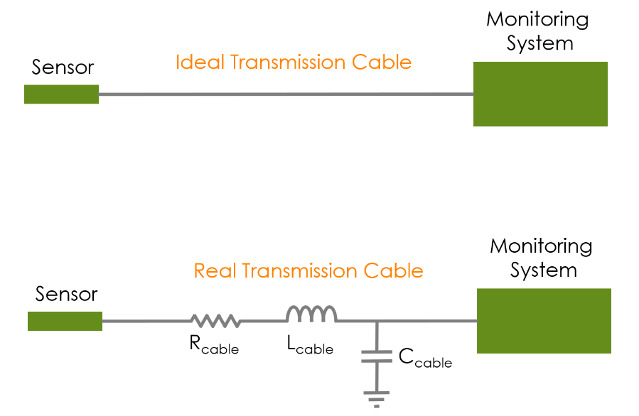

While it is tempting to think of wire as an ideal conductor that gets a signal from point A to point B without alteration, this is often not the case – particularly for long cable runs. In an ideal world, the cable connecting a sensor to its associated monitoring system would be a perfectly lossless conductor that would not alter the signal whatsoever. In the real world, however, the cable exhibits, resistance, inductance, and capacitance ((Figure 1). These values for R, L, and C are typically expressed on a per-meter or per-kilometer basis when SI units are used. These distributed parameters act to alter and distort the sensor signal in four undesirable ways (Figure2).
Low-pass filtering effects: The distributed cable parameters form a low-pass filter that allows low frequencies to pass with little or no attenuation but effectively blocks high-frequency components of the signal from passing. This results in an altered waveform that may be unsuitable for conducting proper diagnostics. The signal may be so degraded that it is unsuitable not just for diagnostics, but protection as well.
Slew-rate effects: For speed measurements, the signal often originates as a rectangular pulse train but distorts due to the impact of wiring capacitance (known as slew-rate). The pulse train shape with abrupt vertical changes originates because the speed sensor is often observing a toothed surface, a key, a keyway, or some other physical discontinuity in the surface observed by the sensor. If there were no limitations on slew rate, such vertical discontinuities could be reproduced. But in real wiring, the capacitance limits the ability for instantaneous changes in signal voltage and the crisp, rectangular pulse train begins to resemble a series of smoothed pulses where the abrupt edges are rounded. While slew-rate rarely affects vibration and dynamic pressure signals, it can frequently affect speed signals.
Resistance effects: Cable resistance forms a voltage divider that drops some of the original signal voltage produced by the sensor across the wiring instead of entirely across the input impedance of the monitor. This has the undesirable effect of decreasing the signal-to-noise ratio.
