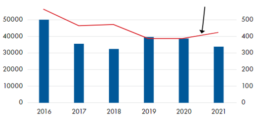

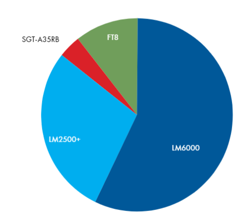

New gas turbine orders down overall 12% (measured in MW) in 2021 but up on 8.5% in the number of units. But looking deeper at the numbers, aeroderivative unit orders in 2021 were up 11% for the year. When viewed outside of the volatile Russian market, aeroderivative unit orders were up 110%. Further, North American aeroderivative unit and ME orders were both up more than 300% in 2021. The LM6000 accounted for more than 50% of the MW orders and the LM2500+ for about 50% of the unit orders.
Worldwide, the LM2500+ dominates the market. It has a five-year share of 33% of all aeroderivative orders, 25% higher than the LM6000 in second place. The LM2500 and LM2500+ each have fleets in excess of 1200, with the Lm2500+ now leading. The LM6000 lies behind at around 1150.

Mark Axford continued the presentation by showing the long downtrend in the gas turbine sector. 2021 was down 12% in overall gas turbine MW orders (including large-frame machines) and up slightly in unit orders.
“What was an annual GT market of 60 GW a few years ago is now a 30 GW market,’ said Axford.

There were 22 LM2500+ G4s ordered in 2020 and 47 in 2021. From 0 orders of the LM2500 Xpress in 2020, GE managed 17 last year. The TM2500 trailer increased from six to nine orders, and the LM6000 from 4 to 26 in 2021. GE LM9000 had a dire year, dropping to 0 from 20 in 2020. And the LMS100 continues fail to register any sales for the second year running.
