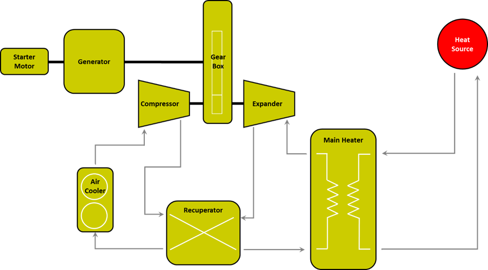

Figure 2: A recuperated sCO2 Brayton cycle gives good performance for a reasonable cost.

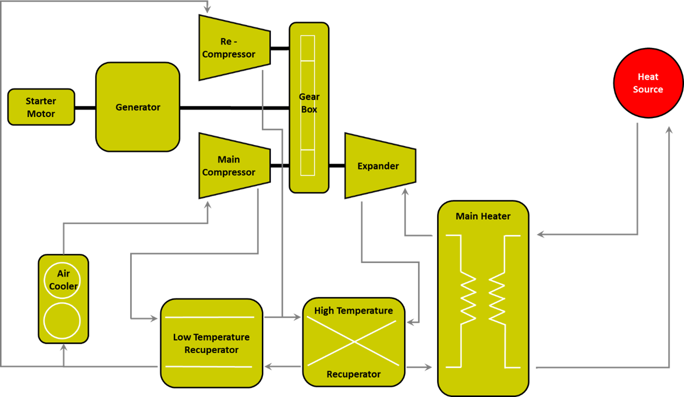

Figure 3: A recompression sCO2 Brayton cycle gives the highest performance but it comes at a premium for total installed cost.

The two most prominent configurations are recuperated and recompression cycles (Figure 2 and 3). A recuperated cycle allows a portion of the unused heat from the turbine to be captured via a heat exchanger, which can then heat the compressor gas discharge, thus reducing the overall required external heat input. The recompression Brayton cycle uses a high-temperature and a low-temperature recuperator. Flow is split prior to entering the precooler, recompressed, and passed through the high-temperature recuperator after being reunited with the rest of the flow that has been heated by the low temperature recuperator. The recompression system offers high thermal efficiency (upwards of 50% depending on temperatures) but is one of the more complex and costly configurations.

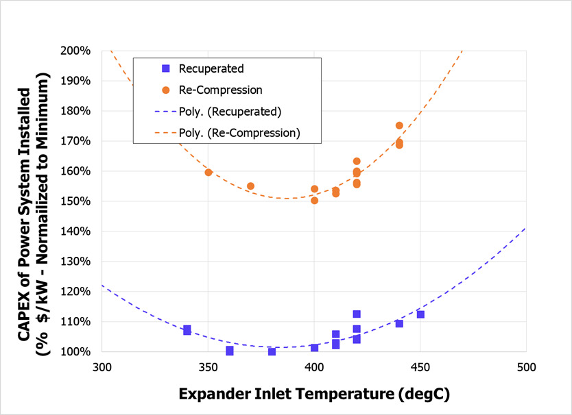

Figure 4: Relative installation cost ($/kW) based on various expander inlet temperatures.

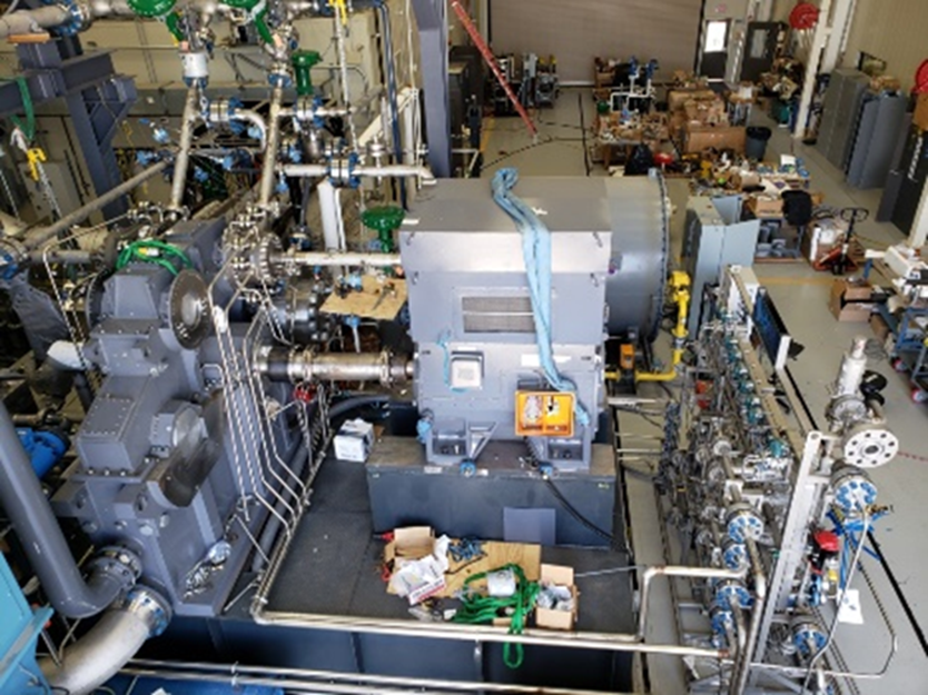

Figure 8: Integrally Geared sCO2 turbomachinery skid on test at Southwest Research Institute.
The preliminary compressor aerodynamic design was scaled and tested in air at Southwest Research Institute. Having this benchmark data allowed the design to be checked prior to testing in CO2. Compressor aerodynamics near the critical point of the fluid are challenging. The gas density flattens and small temperature and pressure changes create large swings in fluid density. This directly affects local velocity vectors. It also makes it difficult to accurately predict aerodynamic efficiency.

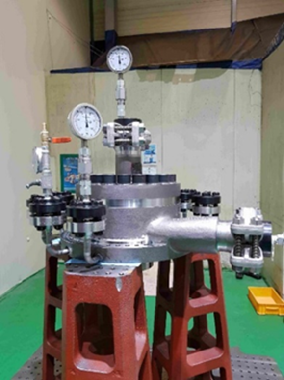

From a structural perspective, understanding the statics and dynamics of the fluid system is critical to avoiding fractures in the material during operation. A hydro test of the high-pressure compressor was carried out at 477 bar (6,918 psi), roughly equivalent to the pressure 2.9 miles below the ocean surface (Figure 7). With the use of finite element analysis techniques, the design succeeded in hydro test and subsequent aero-mechanical performance testing in sCO2 when cycling to holding at full pressure and temperature

Figure 7: The hydro-test of the high-pressure second stage compressor to prove its ability to withstand high operating pressures.
