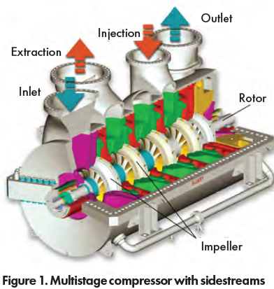

1965 – The previous two versions of the code depended mostly on ideal gas laws and generally assumed the test was conducted at the site installation. This revision attempted to address the growing field of compressor applications using non-ideal gases, and to make provisions for the use of multistage compressors with sidestream injection and extraction flows. It established manufacturing shop procedures for testing gases that differ greatly from the specified gas at the compressor installation site. Some of the concerns addressed included: permissible variations in gas properties between the substitute gas and the actual contract gas, the process to obtain reliable thermodynamic properties of the gases, and conversion of test performance values to the guarantee or specified values.

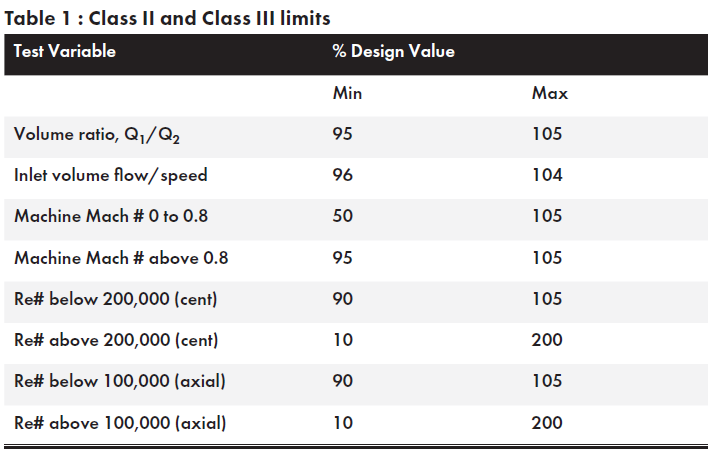

Three test classes were defined. Which test class is conducted depends on whether it was performed at specified gas conditions, or on a substitute gas at different operating conditions. Class I tests are made with the specified gas at the contract speed, inlet pressure, and inlet temperature within the allowable departure (%) limits. Class I tests should be used wherever feasible. Class II and Class III tests are conducted at different operating conditions from the specified and/or other gases, depending on the amount of departure of the gas properties from perfect gas laws. The code defines limits that are referenced to both the specific heat ratio and the compressibility functions. The Class II tests lie within the specified limit values, while the Class III tests fall outside those limits. If these limits are exceeded by either the test or specified gas at any state point along the compression path, then the formulas designated in the code for “real gases” must be used to calculate the performance parameters.
Both Class II and Class III must meet the limits in Table 1 at the design or guarantee operating point. Mechanical losses cannot exceed 10 percent of the total shaft power at the test conditions. This version of the ASME Power Test Code warns that those setting up the test conditions need to verify the accuracy of the gas properties they are using. If the properties are not reliably known, then the test does not comply with the code. Uncertainties in the overall calculations should be evaluated prior to the test to determine if the proposed test will meet the required accuracy. This is the first time the concept of uncertainty analysis was included in the test code. However, the code does not include a method to calculate the uncertainty.

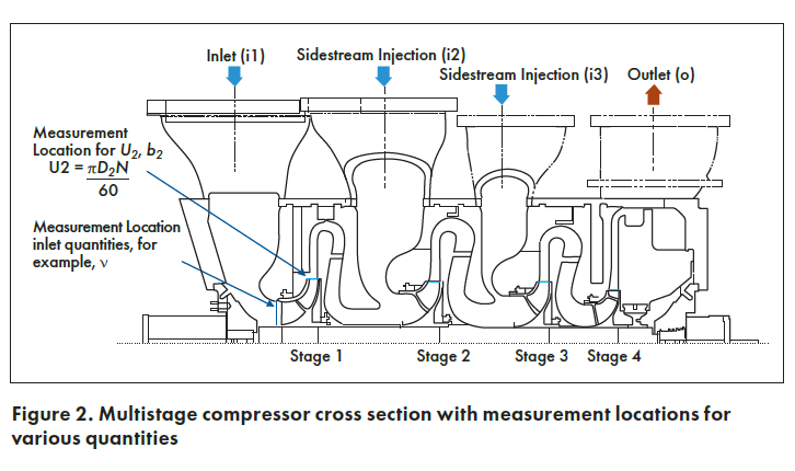

Because of the many petrochemical processes requiring multi-section compressors with injection or extraction side streams, the 1997 code tried to provide better guidance for test procedures under these circumstances. It gives clear specifications for the allowable range of variation of sidestream to upstream volume flow rate ratio. These limits are especially important for Type 1 tests at site where only conditions at the compressor flanges (internal data not available) are normally measured. Type 2 tests are commonly performed at the manufacturer’s facility where internal pressure and temperature instruments can be installed. The code only requires the temperature to be measured internally to allow calculation of both the upstream section head and efficiency, and the internal mixed temperature of the downstream section inlet. Internal pressure is not required to be measured and is allowed to be estimated based on the sidestream flange pressure. It also warns to be cognizant during the test of the flow stream temperature differences, which could cause thermal stratification.
