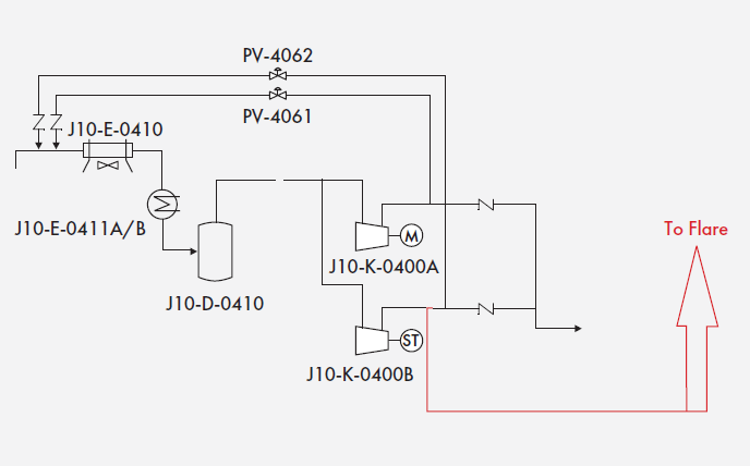

Another is to provide a new recycle line from the compressor discharge to flare so that the compressor-B’s discharge can be depressurized to atmosphere. Hydrogen rich gas would be vented and lost to flaring (Figure 2).

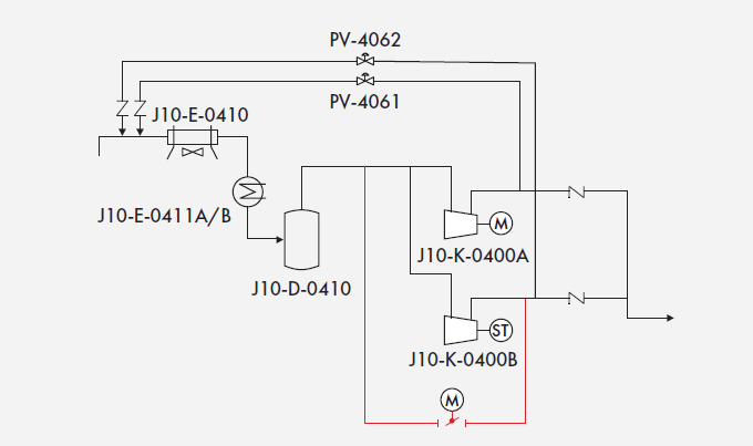

A third choice is installing a new recycle line from compressor-B’s discharge to the compressor common suction before the split to the compressors. This ensures compressor-B operates independently from compressor-A during idling, as both compressors have a dedicated loop (Figure 3).
Figure 3: Proposed piping modifications to enable idling. Courtesy of Saudi Aramco.

Both the first and second options ended up being excluded. One leads to major process interruption and requires extensive effort to shut down and restart the plant. Number two extrudes high levels of hydrogen rich gas to the atmosphere.

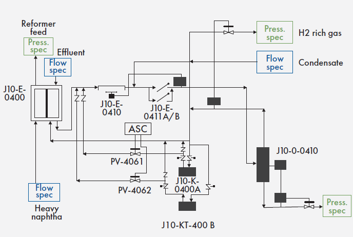

Option three was deemed the best solution. It provided higher operational flexibility, is less harsh on the environment, and only requires minor piping modifications. To eliminate compressor-B surge during turbine idling operation, the discharge pressure of compressor-B must be depressurized and equalized to the suction pressure. This is achieved by providing a new line, bypassing the reactor effluent condensers. With low-speed idling, the temperature rise through compressor-B is marginal, and the required flow rate is small compared to the gas flow rate circulated with compressor-A. Idling operation can be done without temperature escalation at compressor-B’s discharge, as long as the discharge gas is combined with gas from the separator (compressor-A). Here, no additional spillback gas cooler is required (Figure 4).

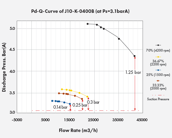

The differential pressure across J10‐E‐0410, J10‐E‐0411A/B and the associated piping is expected to be approximately 0.2-0.25 bar under 50 % operating load, as per a system hydraulics simulation. According to the performance curve provided by the compressor vendor, the allowable pressure differential between compressor suction and discharge in the idling mode (1,500 rpm) is limited to 0.14 ‐ 0.20 bar. Raising the idle speed was needed to meet differential pressure of 0.2 bar at 50% load. The compressor and steam turbine vendor proposed up to 2,200 rpm for idling compressor-B, which is near the critical speed of the train. This wasn’t possible, as the steam turbine would trip due to high vibration near the critical point. Pressure drop across the loop means pressure upstream the condenser will not be overcome.
Figure 5: Proposed piping modification for compressor-B.

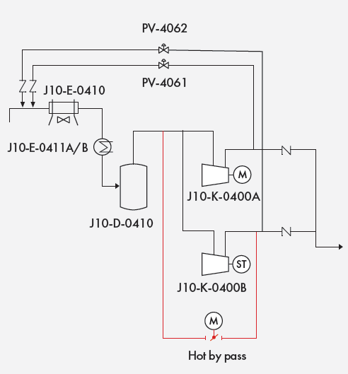

Whenever a compressor trips, the plant operation tends to maintain maximum production from the other compressor, which can handle up to 65% of the plant’s capacity. This adds an additional required discharge pressure to be developed by compressor-B, increasing the differential pressure across E-410 and E-411 to approximately 0.3 bar. Compressor surge tends to occur during idling mode when the compressor J10‐K‐0400A is running. Figure 5 shows how this modification adds more operational flexibility, as it allows compressor-B to work independently from the other compressor during idling speed.
Plant management approved Option 3. Moving ahead, more plant flexibility is expected without the need to shut down the plant. Now, the steam turbine compressor will be reset if tripped. Although plant design undergoes several review cycles, important aspects of the design could possess greater limitations for plant operation. Special attention must be paid during dynamic simulation of the compressor anti-surge system and startup scenarios to prevent downtime costs.
