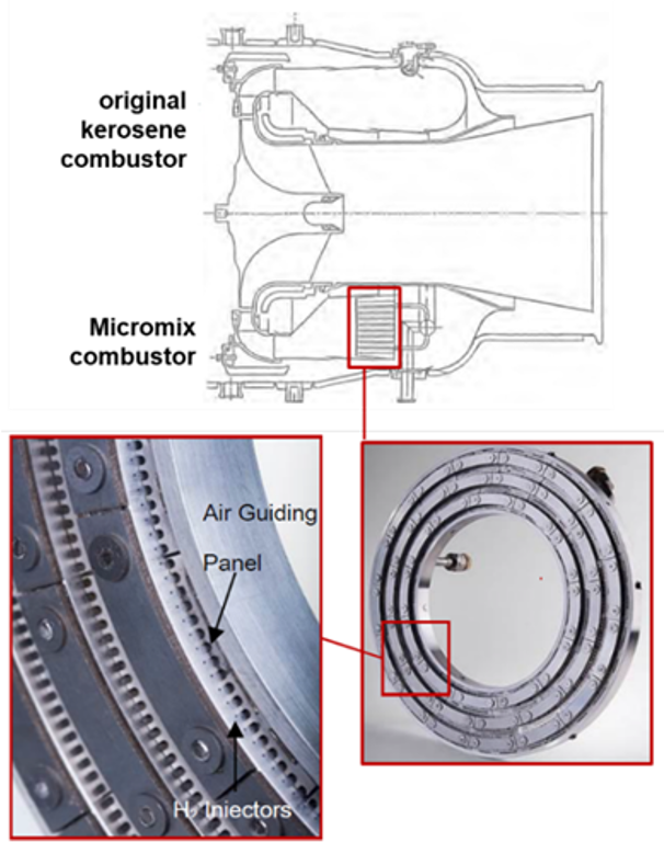

The real challenge, therefore, is how to burn greater than 90% volume of hydrogen at low emissions, without a water/steam admixture, and to fulfil safety, emission, pressure drop, and lifetime requirements inside the gas turbine. The only technology on the market bringing these points together is called Micromix (MMX) combustion.
In research and development since the late 1980s by Aachen University of Applied Sciences (AcUAS, FH Aachen), it has been the subject of many collaborative project s. These have primarily involved B&B-AGEMA and Kawasaki Heavy Industries (KHI). The basic ideas behind the concept are:
- NOx suppression by residence time reduction.
- Jet-in-cross-flow mixing for flashback safety.
To suppress NOx formation, one can either lower the flame temperature or reduce the residence time of fuel/air inside the high temperature zone of the flame. NOx molecules can only form under certain fuel/air conditions and high temperatures. The best course is for N and O molecules to reach colder zones behind the flame before they undergo a chemical bond.
Pure hydrogen cannot burn. A diffusion flame is consequently flash-back safe whilst pre-mixed flames will always carry risk. By the jet-in-crossflow mixing process, rapid premixing lowers the average flame temperature. If the flame travels towards the H2 injector, the mixture becomes too rich to burn and is forced to travel back to its intended position without damage to burner components.

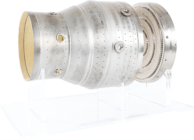

Early designs proved out the general concept and highlighted issues to overcome. By incorporating computational fluid dynamics (CFD) through the help of AcUAS and Kawasaki, this combustor technology was introduced into the Kawasaki M1A-17 gas turbine (2 MW).
Reactive flow simulations were performed in Siemens Simcenter STAR-CCM+ to study aerodynamic flow parameters and the combustion structures (flame shapes). The aim was to find the optimal design and length of the flame to ensure low NOx combustion and reduce the number of injectors. Simulations included reactive chemistry to predict the flame shape, size, and temperature signature. Siemens Digital Industry Services provided model tuning.
As a result of this research, AcUAS and B&B-AGEMA developed the fourth and fifth generation MMX combustor. It includes a new flame shape with very low NOx properties, based on CFD simulation, which was never considered before. The team developed a prototype burner.
An air-cooled borescope was developed to visualize the MMX flames inside the can combustor under full pressure. This optical monitoring device is equipped with an infrared or white light endoscope which can be inserted into the combustor.
The head is located downstream of the flames and exposed to the highest temperatures (>1300°C). This assisted in verifying combustor performance.
The overall target was to have less than 35 PPM NOx at 100% hydrogen from 50% to 100% load, with low NOx values at part-load operation as well. Additional requirements were stable ignition, no flashback, and an acceptable pressure drop. With an intensive program of CFD simulation, design optimization and benchmark validation on low- and high-pressure test rigs, an MMX burner design successfully met these targets.
