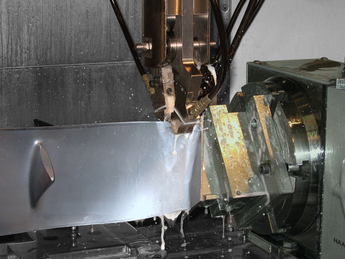

Steam turbine blade being Low Plasticity Burnishing (LPB) processed in a milling machine.

The first step in the investigation was to obtain sample specimens of 410SS machine-finished by low stress grinding (LSG) to serve as a baseline. Compressive stress was introduced either by LPB or shot peening. The LPB process is performed on conventional CNC machine tools and robots. Shot peening was done using a conventional air blast peening system.

Some steam turbine manufacturers are now implementing LPB on their blades upfront to reduce overhaul and maintenance issues. Others use LPB as a faster and more economical repair technique. Depending on the steam turbine, manufacturers can apply LPB with the turbine blades installed on the rotor. LPB as a surface treatment does not add material or change the blade’s balance like traditional welding repair methods.
