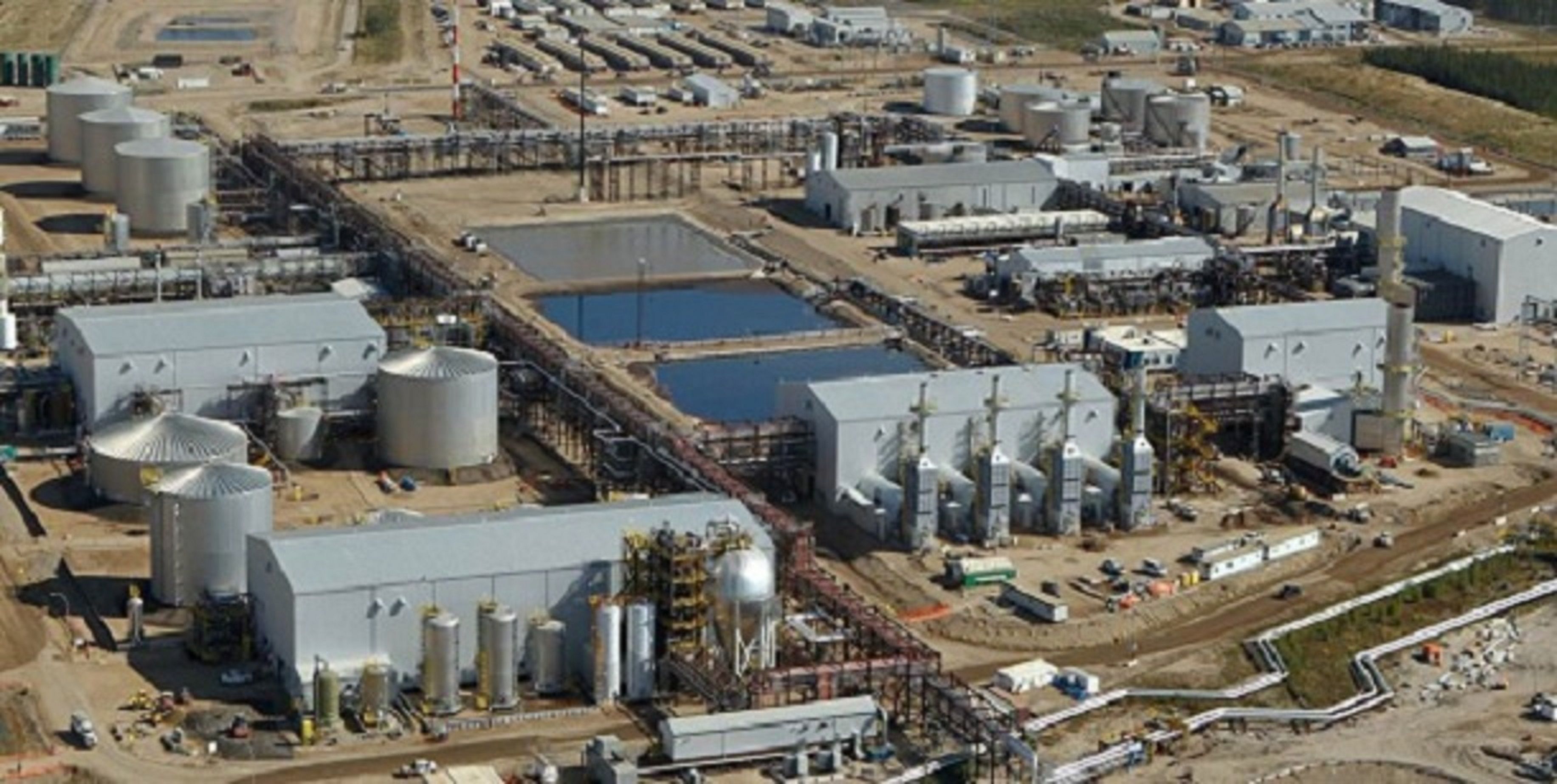

Condensate samples were taken of steam that was being taken from six once through steam generators (OTSGs) and two heat recovery steam generators (HRSGs) to several dozen well pads each with dozens of individual well pads. Each HRSG turbomachine produced 90 MW so a combined 180 MW with some extra headroom reaching 202 MW for peak loading. The HRSGs of oil producing steam assisted gravity drainage (SAG-D) sites make high-temperature, high-pressure steam. But only high-temperature, low-pressure steam is needed to be injected into the ground to liquefy bitumen for extraction, so it makes financial sense to run the steam through turbogenerators.
Above ground pipelines carry steam to the pads and above ground pipelines carry the produced bitumen back to the plant. The bitumen is then treated to separate the oil from the water, gasses, and steam. The steam in a SAG-D site is injected into the ground; heat and pressures change the viscosity of the heavy oil that is trapped in the sand and it flows downward by gravity to collection pipes and is pumped out. The gasses are collected and burned in the steam generators to create heat to vaporize the recycled water from the wells and reuse it.

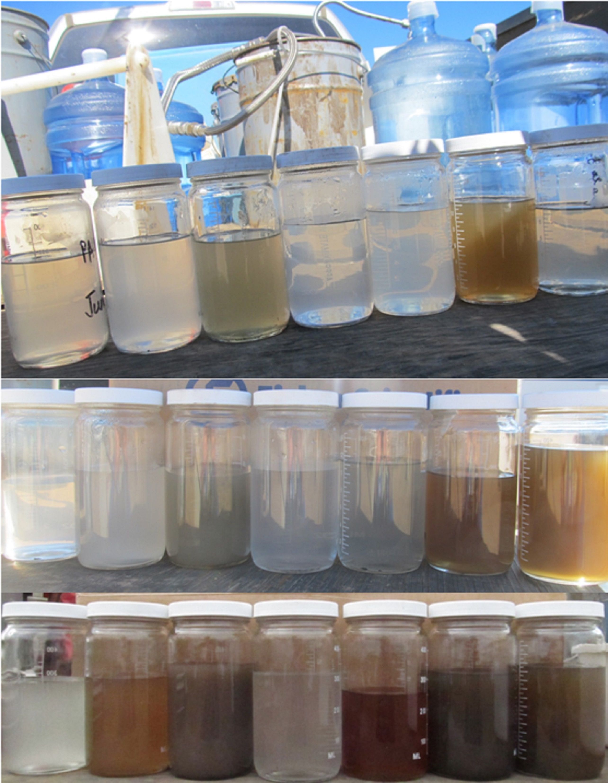

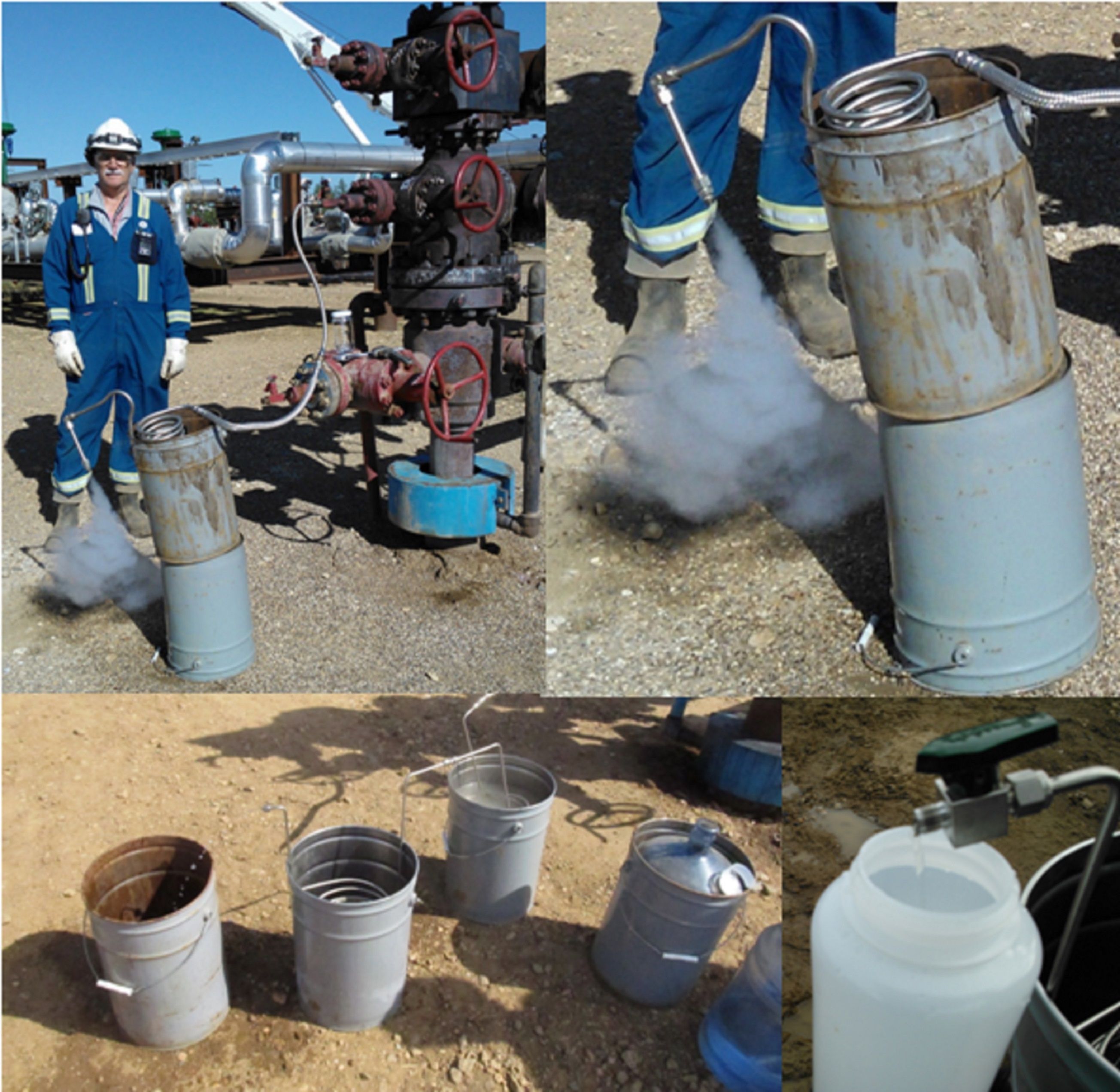

When samples of steam condensate samples were collected from the steam being injected into the ground, the high-temperature, low-pressure steam was run through water cooled coils. The samples were analyzed for pH, residual amines and conductivity and the samples were also run through an Inductively Coupled Plasma Optical Emission Spectrometer (ICP-OAS) for elemental analysis. Samples are burned in a plasma flame that is 2,000°F hotter than the surface of the sun.
The color of steam condensate samples collected varied depending on the well pad, as well as varying from one week to another. Many different tests were run in an attempt to find a statistical correlation between the changing shades. A volatile acid test was done, based on esterification of the carboxylic acids present. All volatile organic acids present are reported as their equivalent mg/L acetic acid. This led to the discovery that the darker the steam condensate, the higher the presence of carboxylic acids (an indication of potential corrosion). This results from this test can be statistically compared to steam generation parameters such as steam qualities, temperature, pressures, carryover, and amine additions for the set points of the steam engines.
