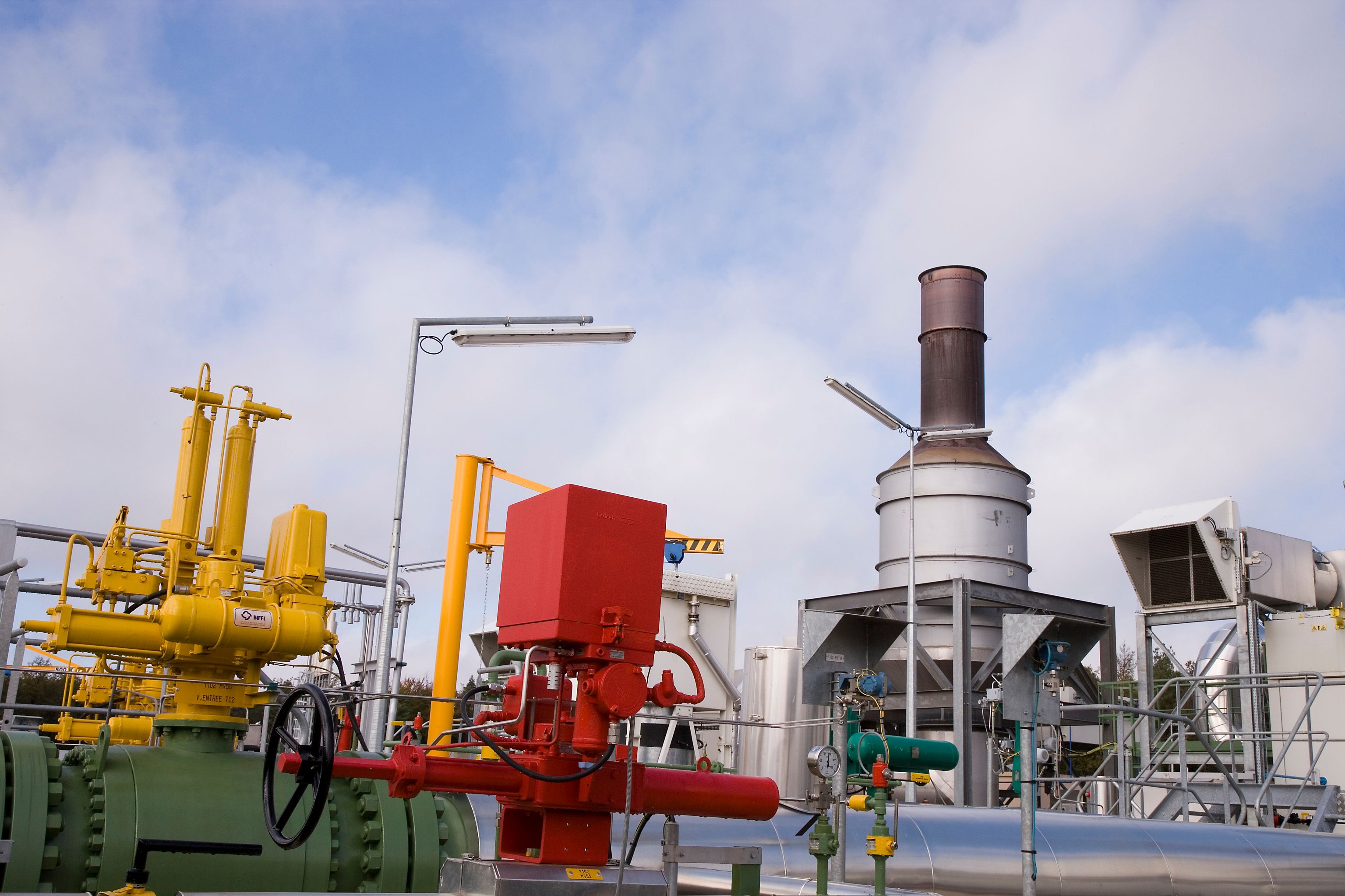

Pipeline operator GRTgaz from Western Europe decided to tackle the problem. Its infrastructure consists of several thousand kilometers of pipeline network with around 10,000 delivery, regulating, or sectioning stations as well as numerous compressor stations. Dry gas seals have been installed at new compressor stations for 25 years, and pipeline venting emissions (mainly for maintenance needs) are fed back into the pipeline with mobile gas compressors. Based on 2016 figures, the company has achieved a two-thirds reduction in methane emissions. The next target is to divide that number by five by 2024.

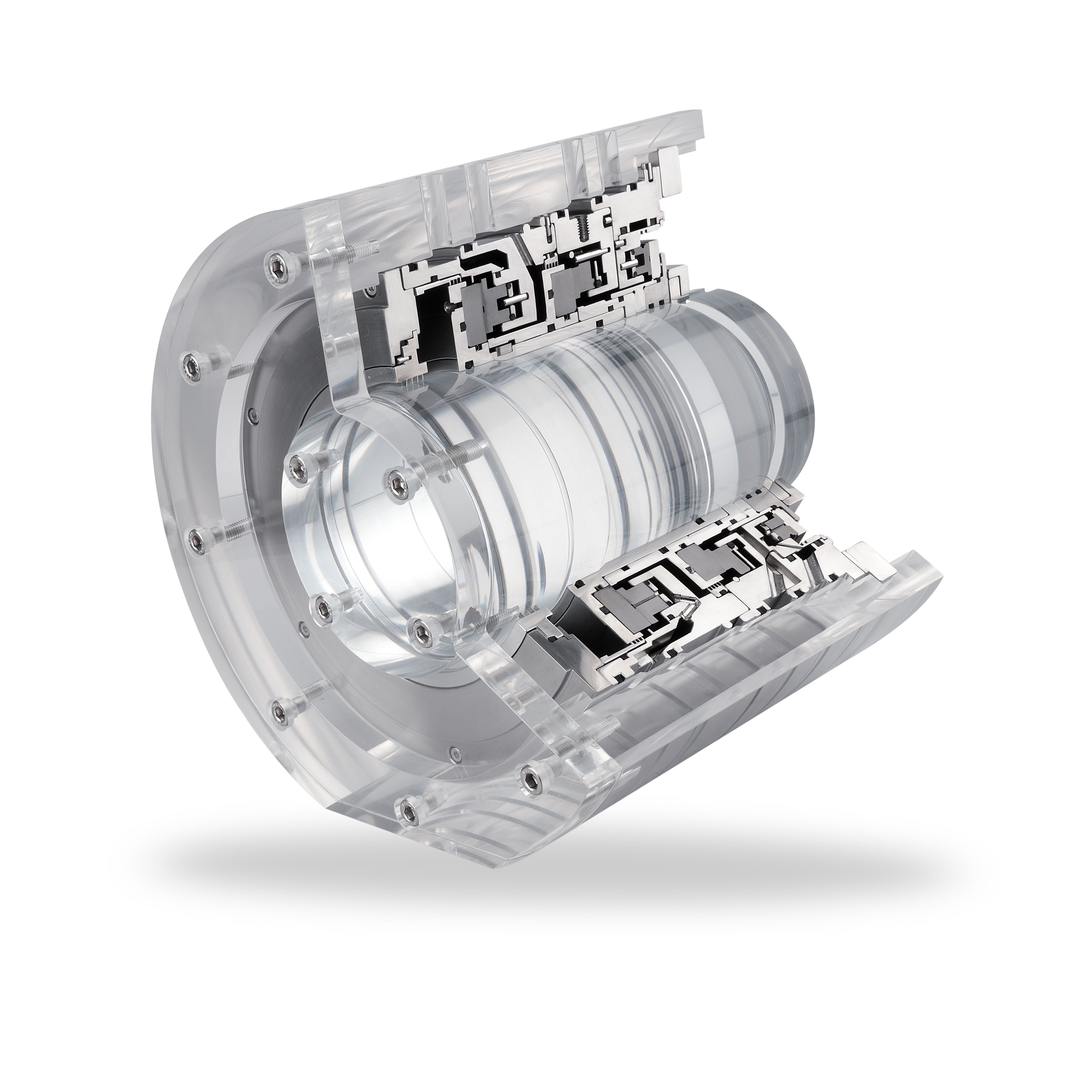

Coaxial dry gas seals designs are similar to double seals. They can prevent leakage, are supplied with nitrogen, and are used at low pressures. The main advantages over double seals: their small footprint (comparable to a single seal) and resilience to nitrogen failure arising from a problem with the nitrogen generator.
This coaxial design has been adapted for use at higher pressures. This gives components more stability as well as additional secondary seal faces behind the coaxial seal to provide a safety level like that of tandem seals. If the nitrogen supply fails, the system can continue to operate with process gas. In such a case, only small amounts escape into the vent line.
This seal eliminates leakage during operation and shutdown. As it is permanently pressurized with nitrogen (N2), venting is no longer necessary. This also prevents contamination. The system operates at up to 160 bar operating pressure, even in the event of an N2 failure. Modifications to the compressor housing are unnecessary. It is suitable for new compressors and retrofits.
Although it can operate without nitrogen, an uninterrupted supply is important for environmental protection and to ensure clean gas. Instead of transporting it to the compressor station, the nitrogen had been successfully generated on site in the GRTgaz pilot project through pressure swing absorption. The nitrogen accumulator that secures the supply operates at 330 bar. Pressure is reduced downstream to the required seal supply level. It is estimated that this new seal design saves on average 230,000 cubic meters of process gas per year while reducing overall operating costs.
