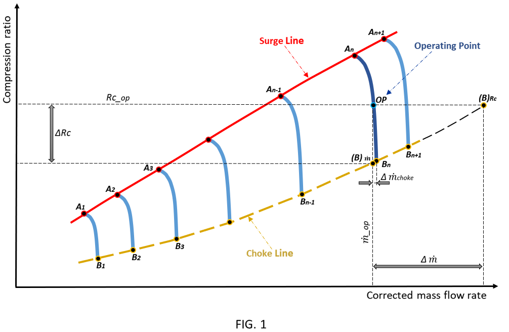

Figure 1: A set of hypothetical constant speed performance curves typical for axial compressors with A points as surge points; and B points as choke points. The operating point (OP) on the curve is located approximately halfway from the surge and choke points.

Close-loop PID controllers are typically used to regulate anti-surge valves to protect compressors from surge, and to regulate inlet guide vanes (IGV) or outlet valves to prevent compressor choking by comparing the controlled variable (CV) to the desired SP setpoint. There are various compressor protection algorithms that calculate the CV that characterizes the position of the operating point relative to the choke line, represented in dimension-less rectangular coordinates.
The most commonly used choke protection algorithm in industrial control systems, or its derivative, defines the CV (%) as the distance from the operating point to a point on the choke line at the same compression ratio. Other algorithms define the CV (%) as the distance from the operating point to the point on the choke line at the same mass flow. In rectangular coordinate systems, the distance between points on a curve and the curve itself are projections onto a horizontal or vertical axis.
The first algorithm requires extrapolating the choke line so that the vertical coordinate passes through it. Compressors are selected to operate at points with maximum efficiency, somewhere between the surge point and the operating point OP (Figure 1) in a curve where the accuracy of calculating the controlled variable to protect compressor from choke is minimal, since the position of the point (B)Rc is an assumption. The accuracy of the operating point calculation increases as the choke point is approached, but may still be inaccurate within the safety threshold.

Algorithms of the second type seem preferable, since the projection of the operating point on the horizontal axis always intersects the choke line. In such algorithms, the displacement of the operating point is determined by the vertical coordinate of the compression ratio as a function of the horizontal coordinate of the corrected mass flow rate, then a small change in distance between the intersection point (B) on the choke line and the choke point can significantly change the distance, which makes it difficult to tune the PID controller for its fast response.
Setting the safety threshold in rectangular coordinate systems can only be made relative to the choke line, since the entire operating range is not available. The compressor performance curves on the plane are geometrically limited to perpendicularly oriented lines to reproduce the entire operating range from the surge point to the choke point, which is achievable in a polar coordinate system defining this range as a rotation from the polar angle to the polar angle. Therefore, the controlled variable CV (%) for the choke protection controller can be calculated as the choke point polar angle minus the operating point polar angle divided by the entire range, which is equal to the choke point polar angle minus the surge point polar angle.
