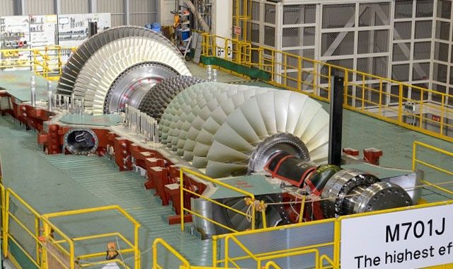

Equipped to support 30% hydrogen co-firing, Mitsubishi Power’s J-Series gas turbines can produce up to 700 MW of electricity while reducing CO2 emissions. (Photo Credit: Mitsubishi Power)

Energy sector players need not start from scratch to ramp up hydrogen utilization. They can use existing gas power infrastructure. For decades, the energy sector has already successfully used hydrogen in various proportions within small gas turbines. The next step is to develop larger machines that can safely deploy hydrogen for utility-scale power generation. To date, there has been success in converting large gas turbines with dry low-NOx combustors to run with a 30% hydrogen and 70% natural gas mix. Exclusive hydrogen-firing is projected for 2025.
Conversion of legacy systems to accommodate hydrogen firing can be done with minor structural modifications. Piping and valving sizes must be increased given the greater volume of hydrogen needed. But the compressor, turbines, and other auxiliaries can remain largely the same.
To ensure the safe deployment of hydrogen in large-scale power generation, the combustor design has been reimagined. Most existing large gas turbines can run with up to 20% H. But as its proportion increases, hydrogen’s explosive nature and wide range of flammability must be addressed. One notable effect of the significant rise in temperature with hydrogen combustion is the increase in formation of NOx.
A higher incidence of NOx emission can be mitigated by premixing fuel and air before entering the combustor. However, doing so poses a new challenge. Adding hydrogen raises the combustion speed of the fuel mix. It accelerates flame propagation to the point where it may exceed the fluid velocity of the premixed gases. This increases the risk of flashback – where the flame moves upstream in the fluid and can ignite fuel outside the combustion chamber.
A dry low-NOx combustor with an improved swirler nozzle has been developed to mitigate this challenge. Air is injected from the tip of the nozzle, increasing the velocity at the center of the swirling flow. This design boosted flashback resistance while enabling low-NOx combustion.
