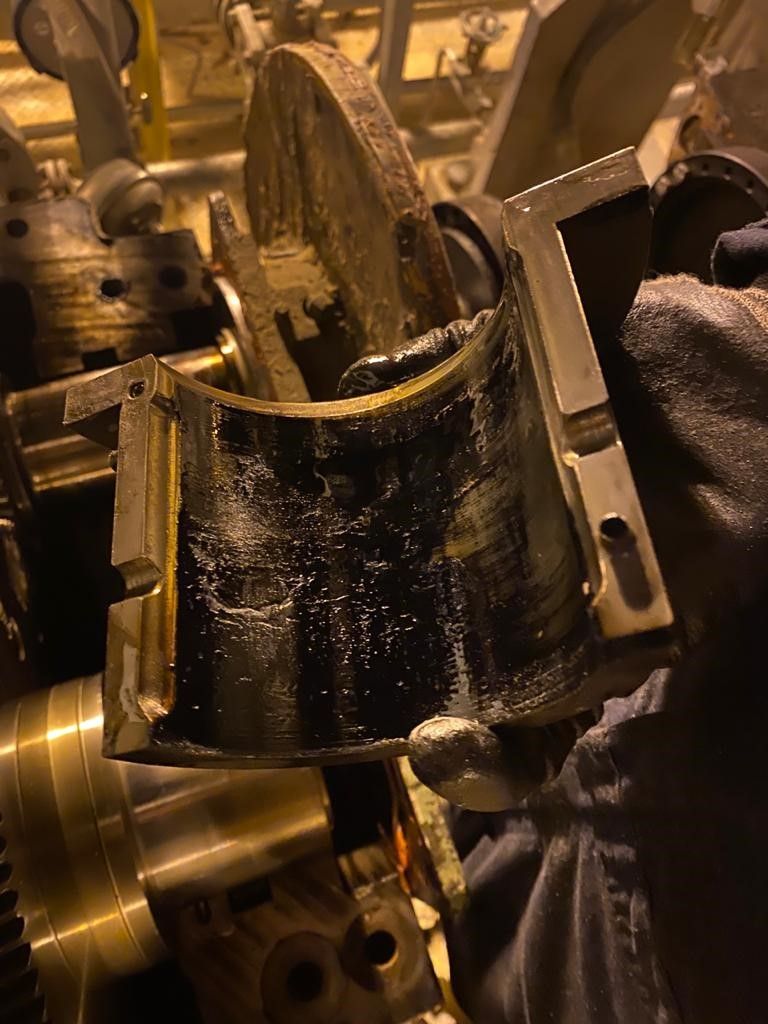

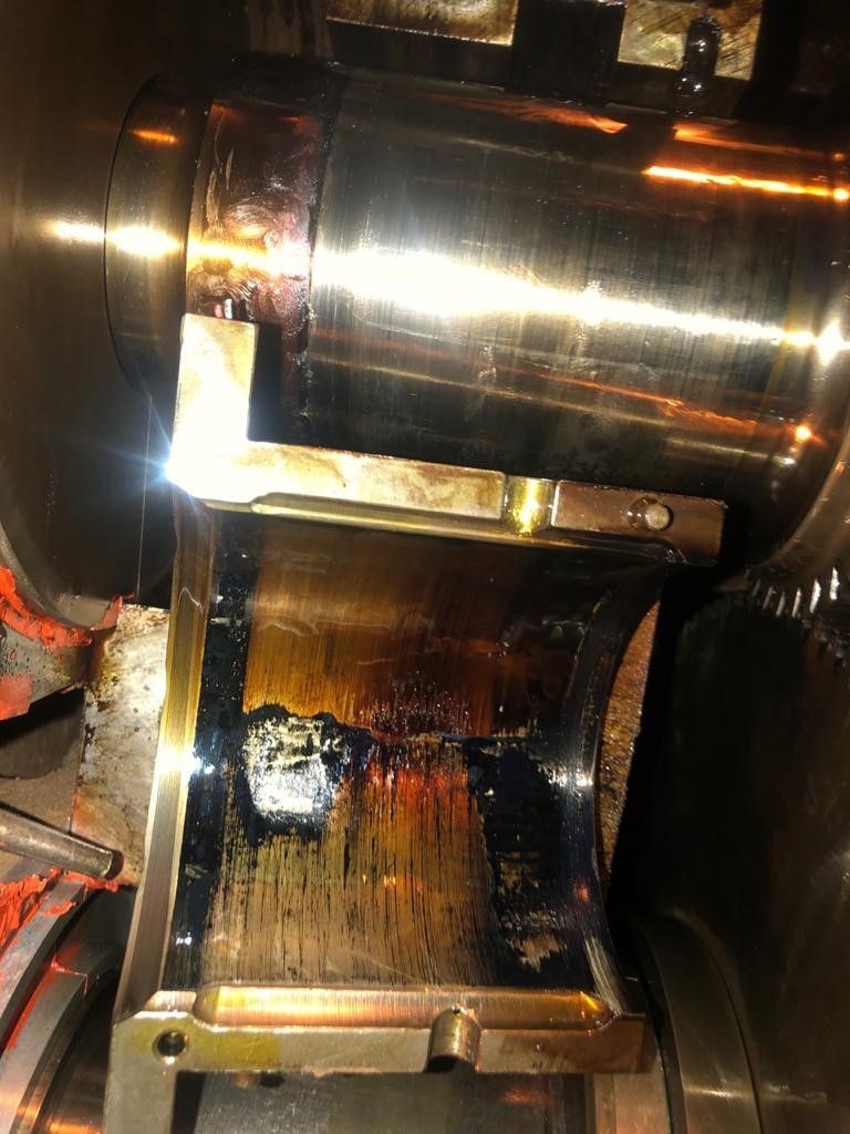

Figure 1: Varnish was found in the compressor gearbox, bearing, and shaft.

The bearing temperature trend of the LP compressor showed a gradual increase at the inboard (I/B) bearing. It reached above the limit of 250oF and resulted in a trip. The bearing was dismantled, and varnish was found on the bearing. This lowered the oil flow rate because of reduced clearance and a reduced heat dissipation rate (Figure 1 and 2).

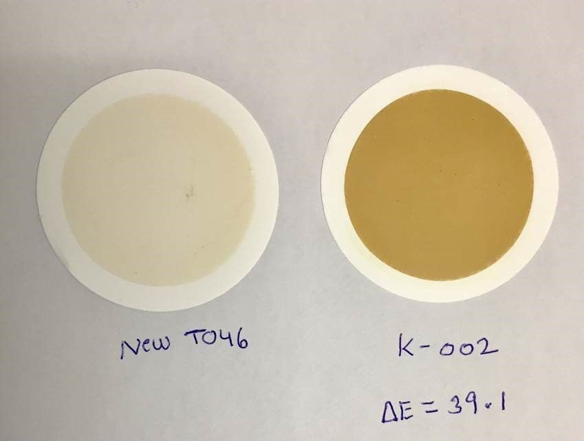

Figure 2: The lube oil sample testing revealed a very high level of varnish presence; the test result for new (left) and in-service lube oil (right).

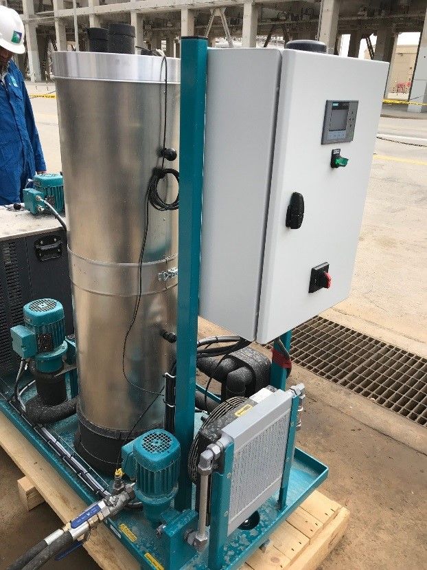

An offline Varnish Removal Unit (VRU) was connected to the LP gas compressor lube oil system while the machine was running. The VRU suction is taken from the lube oil reservoir drain valve. The VRU discharge is returned back to reservoir through a one-inch socket welded on the reservoir inspection manway.
The VRU utilizes filter media optimized for varnish removal. The warm oil is drawn from the system tank to the VRU by means of the transfer pump. The oil first passes through a blast cooler, then a heat exchanger and finally a chiller system before reaching the filter housing. The oil temperature comes down to approximately 50°F before reaching the filter media that captures dissolved and suspended soft contaminants.
Varnish has traditionally been defined as an insoluble deposit. However, it also exists in soluble state. The conversion between soluble and insoluble varnish is a physical equilibrium process dependent upon temperature. The soluble varnish becomes insoluble by reducing the lube oil temperature and can then be removed easily from the lube oil system.
After extracting the varnish from the lube oil, it is returned to the main lube oil system. Varnish-free oil now starts to clean system components in contact with oil, resulting in a varnish-free system for up to a few months depending on system condition.
After utilizing the VRU for a few weeks on the LP gas compressor, bearing temperatures and the condition of the lube/seal oil were improved. Oil samples subjected to MPC tests showed a drop from 39.1 to 1.4 within 19 days of operation. Bearing temperatures dropped from 249.4oF to 186oF within 19 days due to the removal of varnish and better heat dissipation as well as increased oil flow.
The varnish removal unit utilized by Saudi Aramco. Courtesy: CJC.
